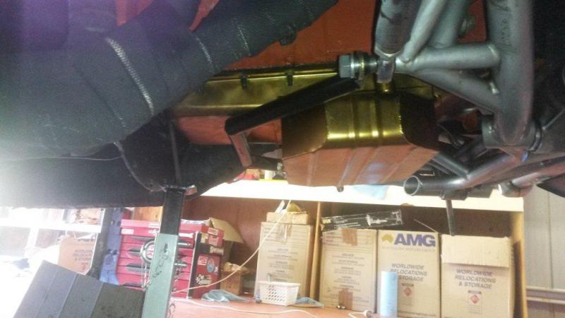

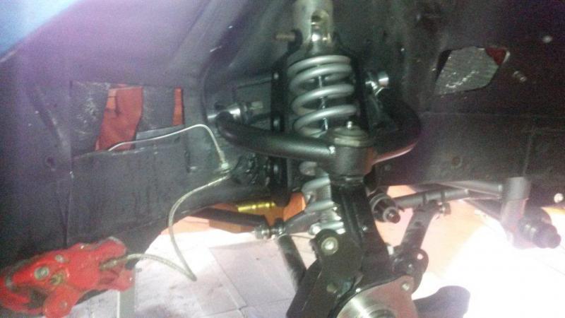

I have the magnumforce front end, alot of people say they dont like the idea of the shock mounting in the original position as it is a weak area. Magnumforce said it is fine as no massive drag launches or extreme racing.

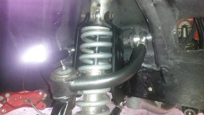

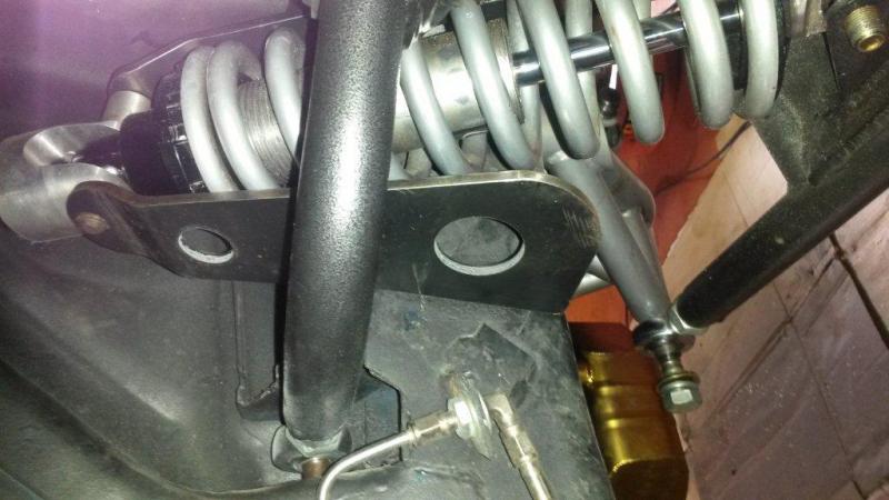

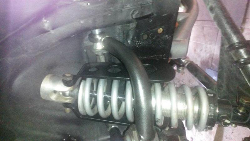

I figured i would strengthening up the area anyway and here is my mod.
the brackets i got laser cut, then i punched the holes for weight and strength.
I also tig welded up a rear brace for strength between the chassis, which you can just see.
plan on doing a little autox soon.
