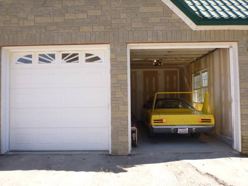

Gotta agree, somethings wrong with the OP's car. My wife has the nose of a hound dog and she never once complained when I parked in "her" garage!.. WELL she DID give me **** for the black marks!
