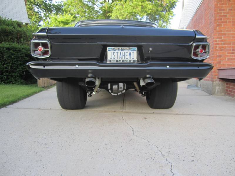

And now I have a 4 inch exhaust now with tail pipes:rolleyes:
No longer am issue!
