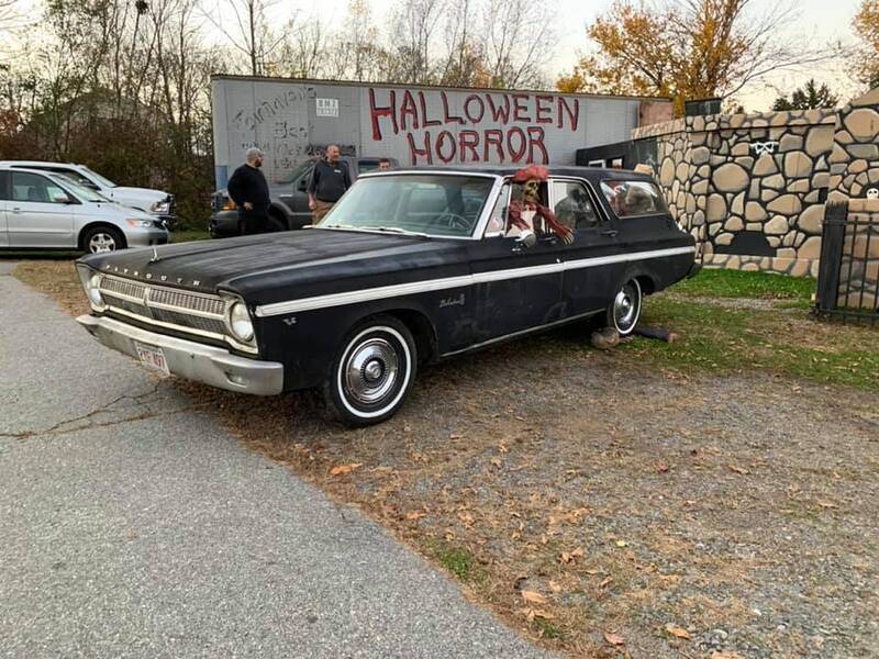

Well since we bought the 67 Fury wagon. That is pretty much going to be for the wife. I sold my 65 Coronet 4 door /6. I was also going to sell our 65 Belvedere wagon however.......... I've decided to keep it (haven't told the wife yet). I plan on going a little old school with it. Raise the front a bit. Put some bigger tires out back. I found some old school traction bars I had laying around. I'm thinking of just keeping the front bench seat in it like a sedan delivery so I can use it to haul stuff to collectible shows that I do.
My question is, I plan on pulling the 273 and just freshen it up a bit. I want it stock with a 2 barrel just for cruising. What's a good coated set of headers? I figure to give it a little attitude with duals.

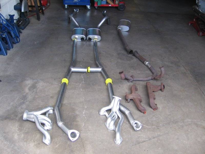

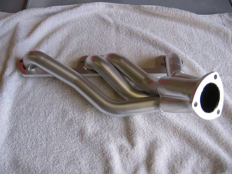

To update this thread. I'm installing a 360 and going with TTI shorty headers. Thanks for all the input.
TTI Shorties ! They fit great took a total of 10 minutes to install.
Don't forget the head pipes if not going for a complete system.It will make your life easier.
