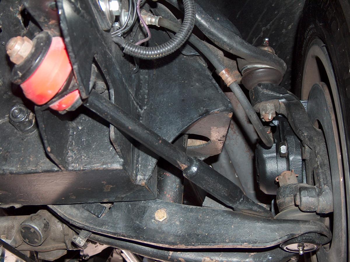

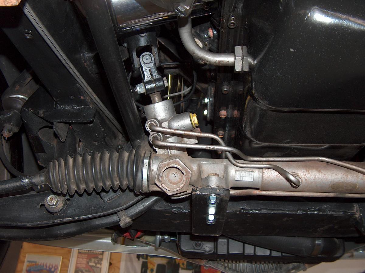

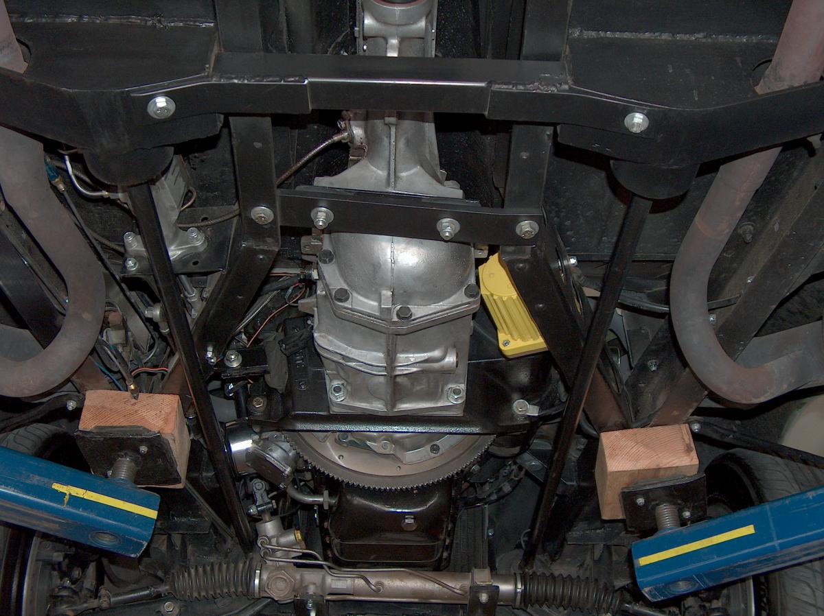

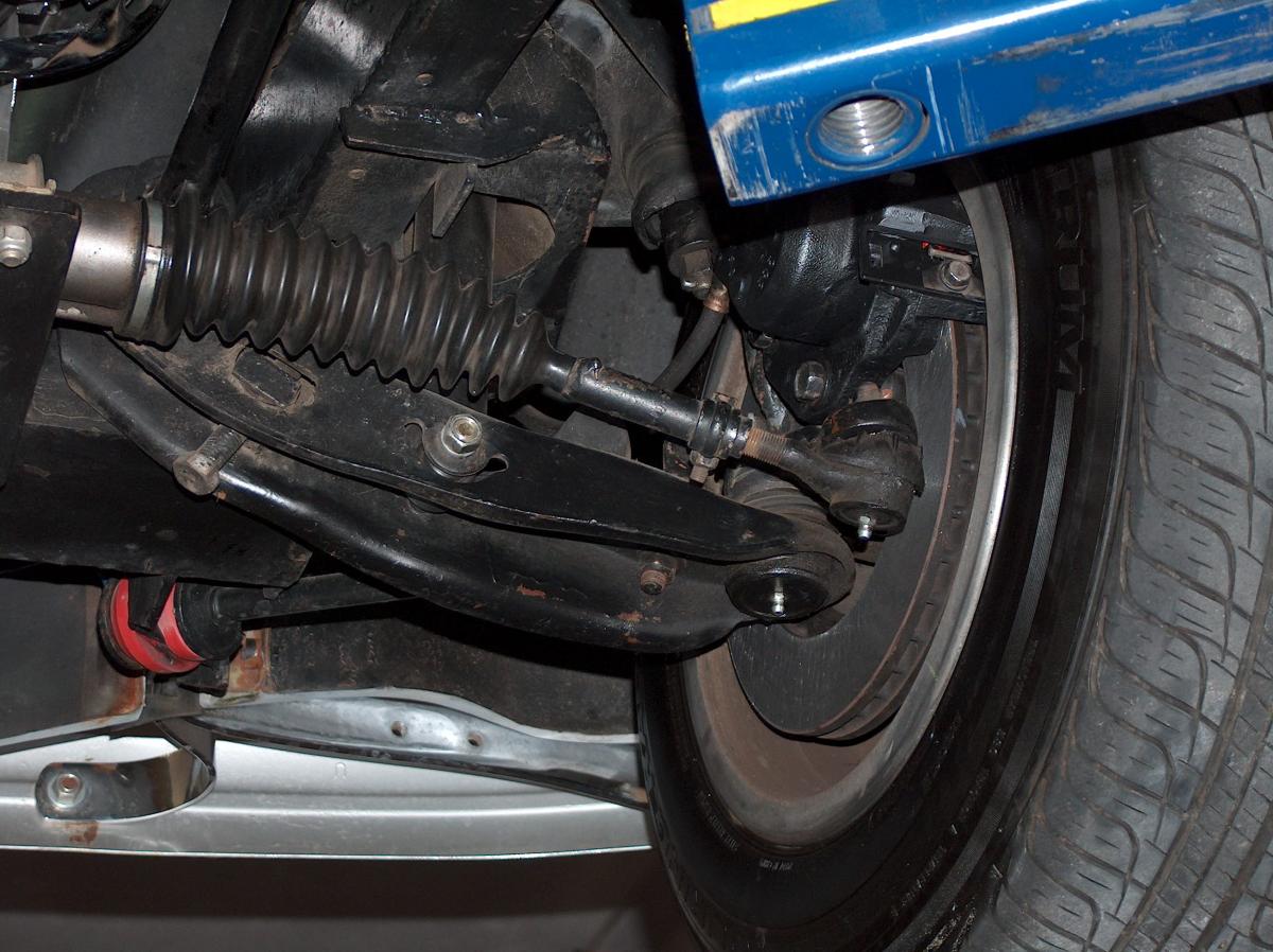

I'll get the car in the air today and measure and look for a stamp on the bars. If the stamp is on the rearward end, you can see from the picture that it might be hard to see. Looks like there boxed in. The guy built this like a tank. No lack of steel reinforcement. I guess that's far better than the alternative. Shocks go through the arms, and are type with threaded studs on the top, with eye's on the bottom. Here's a few photo's. I have changed the spindles (Fatman 2" drop for mopar) since these were taken. I was able to back off the torsion bars quite a bit, and maintained the stance once those were installed. It really improved the ride.
Checked the numbers on the torsion bar ends - Drivers side = 659L/253 Passsenger = 658R/263. They appear to be closer to 42" from rear of bar to front mount.
