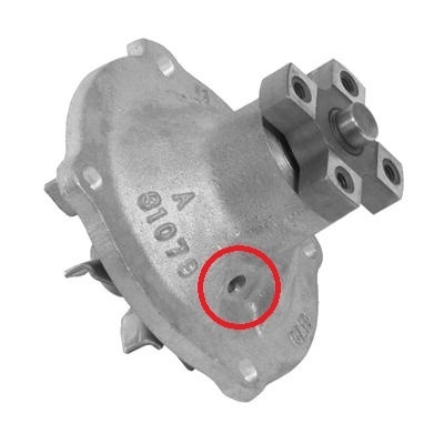

Water pump weep hole.
i have literally replaced every hose and gasket, everything is dry to the touch and to the eye. the only coolant you can see is on the balancer running down the pass side and leaving a puddle on the ground overnight, pulleys are dry, if it was the weep hole it would drip on the pulley, but i have put tissue in the water pump pulley and it comes out dry, as is the pump itself
