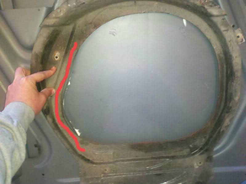

I've got my hood all taken apart, drilled all the rivets for the air grabber ductwork and removed it all so I'm dealing with just the metal hood.

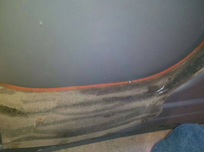

I'm looking at the center section of the hood and I can see that it looks like the hood skin was sort of glued to the understructure in certain spots from the factory.
Mine has come loose from where it was "glued" , as in, the outer skin is floating free from the under structure in the center of the hood about where the main center portion of the air grabber and air cleaner boot fastens to the underside of the hood.
I'm wondering is I need to have that hood skin set back to what looks like an original height? as in, repair those glued spots?
I wonder if maybe at the factory they attached the air grabber pieces to the understructure with gobs of this factory adhesive between the outer hood skin and understructure, then pressed the hood skin firm to the air grabber unit and let it set up???
Anyone??

Well, it looks like the hood skin wants to float free from the underframe.
I see the break and free air space gap in the original seam sealer between the under frame and the outer hood skin.
So, do I try to duplicate the factory height for the skin from the underframe with possibly a decent quality adhesive?
Or do I let it float where it wants to be in a natural state and bridge the natural relaxed skin to frame gap with seam sealer and use a thicker seal/gasket between the main air grabber center duct and the hood skin?

Hood skins are such a trampoline... I expirimented a bit tonight with the hood laying flat on the garage floor and pressed that center of the hood down tight to the original contact points at seam sealer areas. It looks to me like the hood skin surface would be forced out of ... well forced out of straightness.. if that makes sense?
I'll keep after it and make a descision along the way, but for right now I'm thinking that if I forced it back to factory placement I'm going to have a wavey hood.

I looked at it more last night, I do need that hood skin pulled tight to the center window of that stamped hood frame because the gasket for the main "plenum" for the air grabber rides partly on the stamped hood frame edge and then steps down and seals against the hood skin itself.
So, for it to work correctly and look like it's supposed to I do need to get the skin pulled tight and adhered to the stamped frame.
Dammit.
right through this area (red line) the air grabber plenum seals to the stamped hood frame ledge.
All the rest of the way around it seals to the underside of the outer skin. So, it does need to be drawn fairly tight to the stamped frame.
