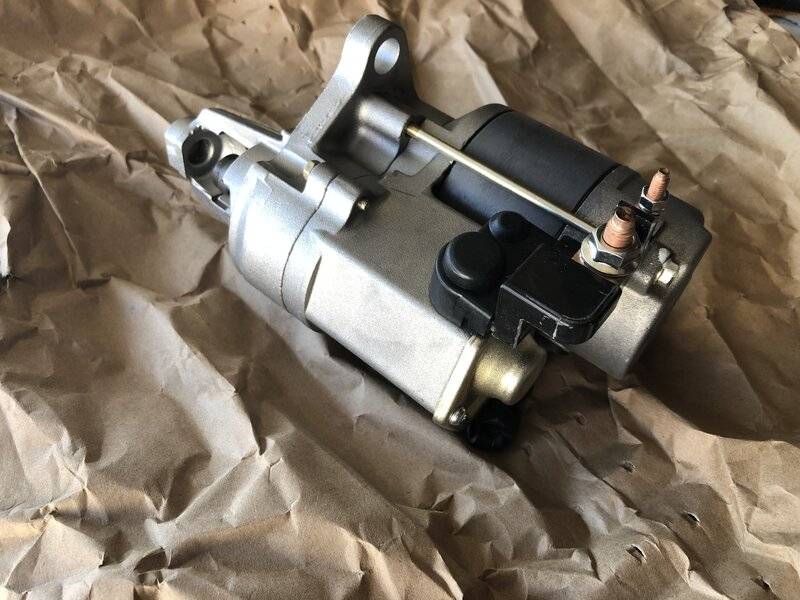

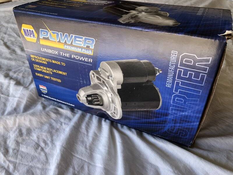

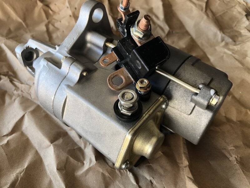

just tossing up a thread using Napa 2441083 Starter (kinda just for my notes).
installed today on my 440cu with a TKO500 combo no issues.

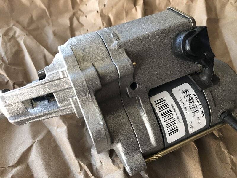

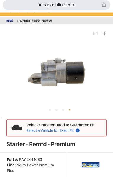

the pic up on the Napa website looked like the original style starter i was used to but what was in the box looked like all the new PowerMaster/MSD stuff.

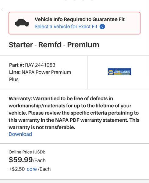

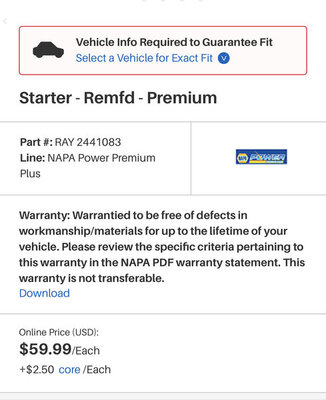

Site says Reman. 59.99 plus 2.50 core? Does that sound correct? RUFFCUT
Put one those in no issue with studs hitting block. Seen guys complaining about that.
Ruffcut - yes - Remanufactured. $59.99+$2.50 core.
Tip: order online and create a Napa account to get $5 discount
i took off that plastic part in the pics above but maybe i didn’t need to.
anyhow, did multiple starts and works like a champ. it has a new sound compared to the older starter...sounds cool.

Ruffcut - yes - Remanufactured. $5.99+$2.50 core.

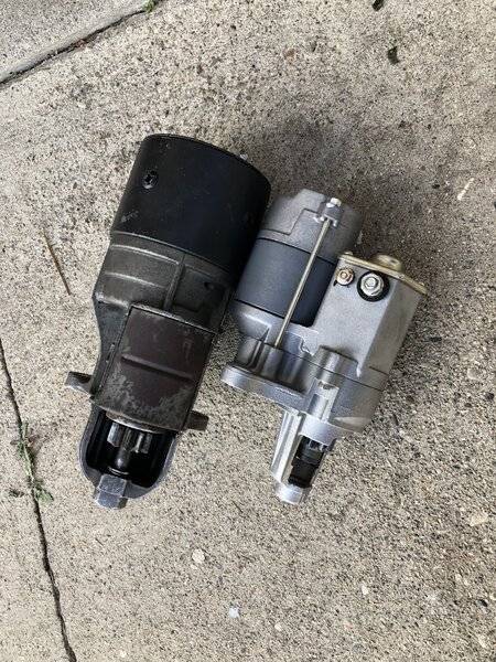

Is this the same as the mini starter from the 5.2 and 5.6 Dakotas everyone was going to in the 90s?
Or different?
Or different?
Yeah, what's the weight comparison between the two?
I bet the weight difference is more like 10 lbs. Could easily hold starter in the air while putting the wires. Try that with a regular starter, always resting it on anything. Edit the top was added after my 10 lb guestamint.
not sure on the dakota ministarter aspect but it may be. might be old news to some but new to me.
and yes much lighter.

View attachment 1059692 View attachment 1059692 I bet the weight difference is more like 10 lbs. Could easily hold starter in the air while putting the wires. Try that with a regular starter, always resting it on anything. Edit the top was added after my 10 lb guestamint.
Pretty decent weight savings in addition to the displacement savings and ease of putting on or taking off.

Seems like I recall the terminals were in an acqward spot. Were they?
not bad. being lighter to work with, i didn’t even think about anything else when installing.
doing the long upper bolt trick to hang the starter on makes it easy too.
