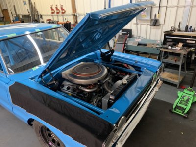

Here's my set up. Do not hard mount it directly from the motor to the firewall cowl induction, the motor movement will tear it up. We copied the NASCAR approach and had a leather "belt" made that joints the air cleaner to the firewall softly. I also have a Nichel's NASCAR intake for the same application I can make available.

I have poly mounts on my 440 and there is zero movement just a thought

Do you know a source for that air cleaner housing or did you fabricate it? Looks great!
