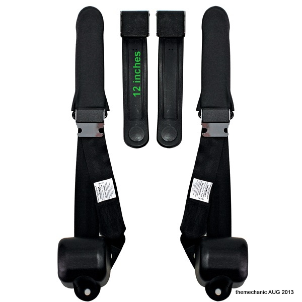

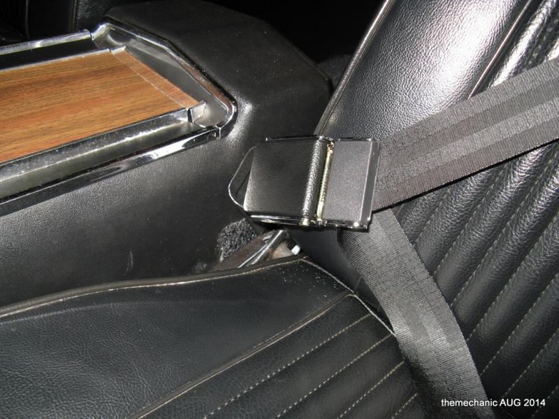

I installed a nice set of 3-point seat belts for bucket seats (Part #MN727BLKU) from Near One (yes, I mean Year One). They look great; I wish I could say they fit great, too. The problem is the latch side that goes between the console and the seat bottom is too short. Dang near trapped myself in the car when I buckled the seat belt to see how it worked.
So, has anybody else had any trouble with their seat belts?
Here's a photo of the part in question:
*****8-26-13 UPDATE*****
I contacted Year One. Their solution was either return for refund (at my own expense) or ship the two 12" belts to the manufacturer in Florida (also at my expense) who would custom make the belts but not the plastic sleeves.
*****8-26-13 UPDATE #2*****
I crawled under the Coronet to look at the bolt holes for the front seat belt anchors on the tranny hump. Whoever owned the car before me had replaced the front and rear floor pans and welded the seat belt mounts in the wrong place. One is about 3/8" farther forward than the other and they are both about 3" shy of where they ought to be. So, I guess I'll get some custom buckle belts made.

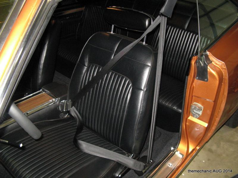

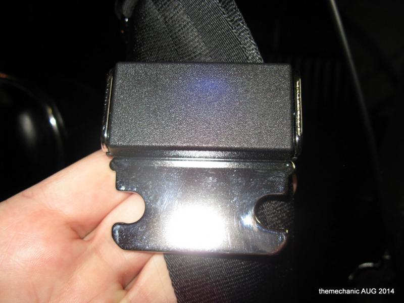

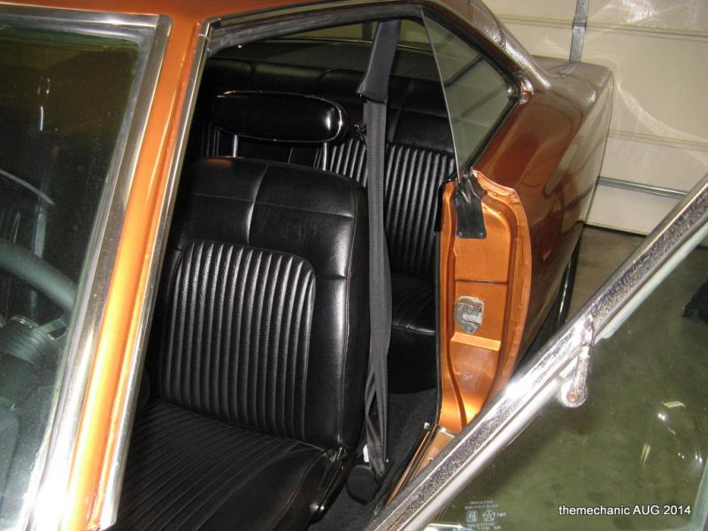

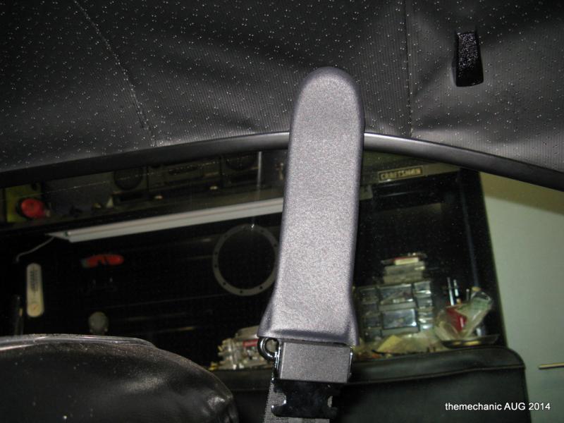

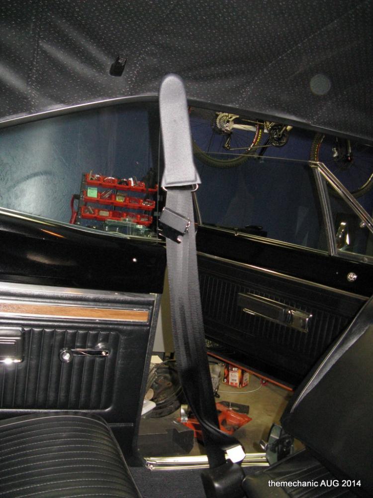

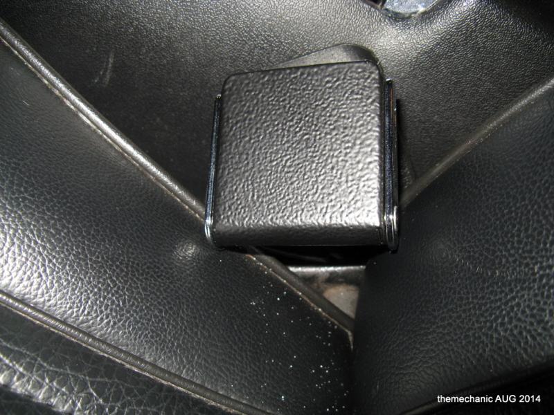

I got the belts installed today. I had to drill holes in the new floor pans to get the 12 inch latch side close enough to the seat. I cannot understand how anyone could be three inches off even eyeballing those bolt hole locations.
Anyway, they look great and work well. You have to push them aside to get into the back seat. The OEM style buckles are a little heavy but the springs are strong enough on the retractors to reel them all the way in. I'll post some photos later.
They ride a little high on the neck (I'm 5'8"). They retract well now but may not when they get older since the buckles are kind of heavy.
Here are some photos I took tonight. Better late than never.
