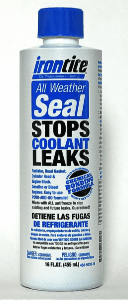

I've used this a couple of times, it worked well and showed no bad effects later. Once was on a GM 3.4 v6 that would have meant stripping everything down to the timing chain cover and once was a neon head gasket. The fix seemed permanent.
