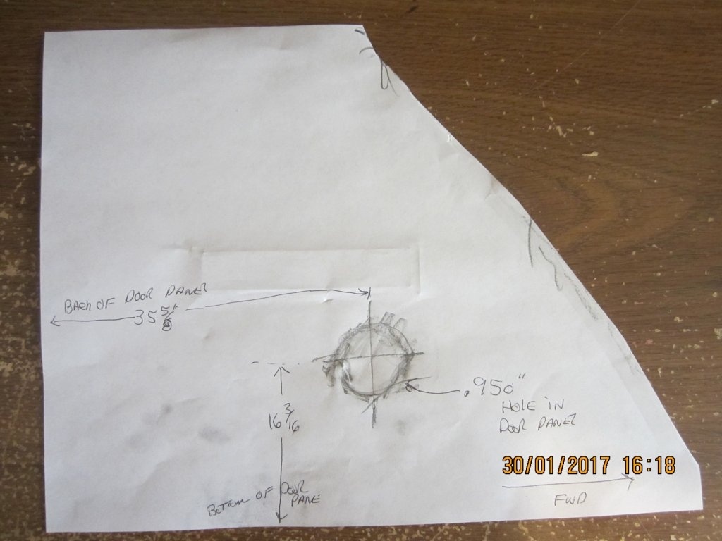

I am looking for the Remote Hooded mirror Template that mounts on the Fender
Thanks
I have a 1965 Dodge Coronet 440 two door hardtop in pieces. It had a remote mirror on the drivers side. I can make a template and send to you. Will this work?
Yes, can you also send a photo or template where the control goes inside
Thanks
Thanks

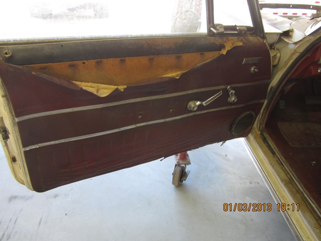

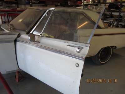

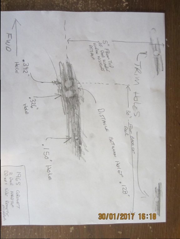

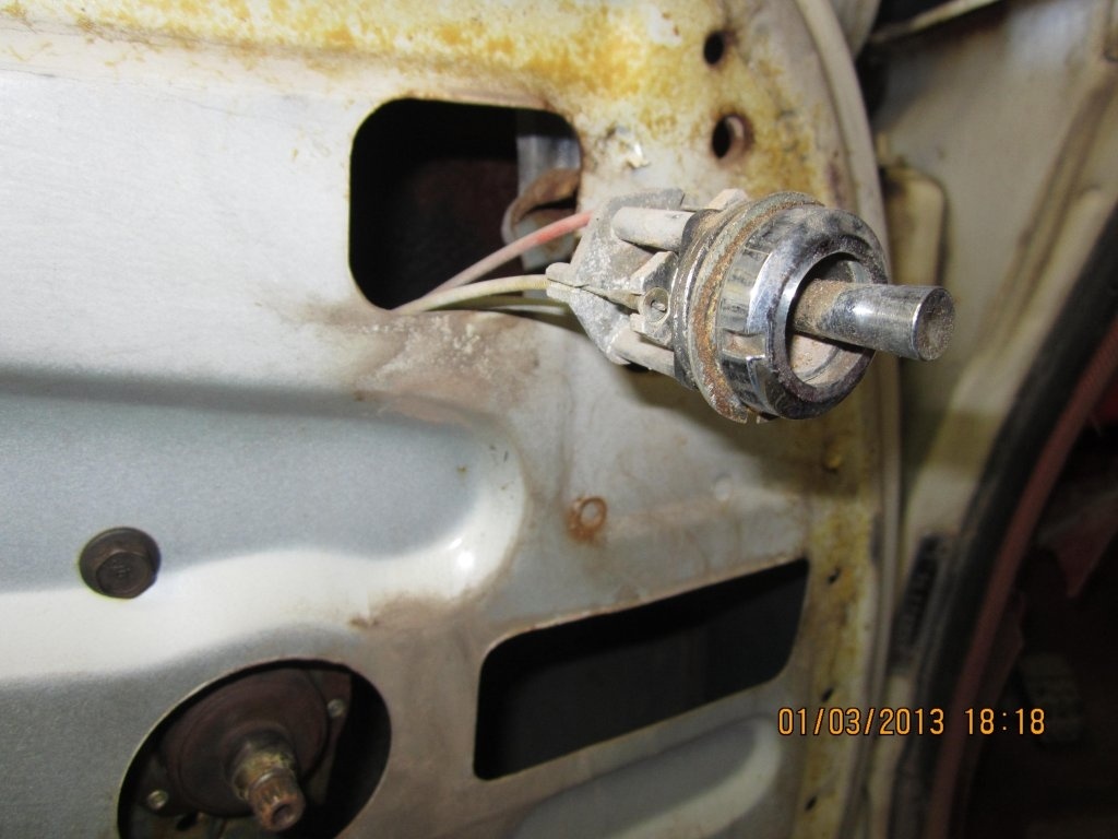

Here are some photos and a template. I don't know if a 65 door has similar dimensions of a 62.
Photo #4583 shows the hole in the door where the control knob passes thru. The hole in the door panel must line up with this hole.
