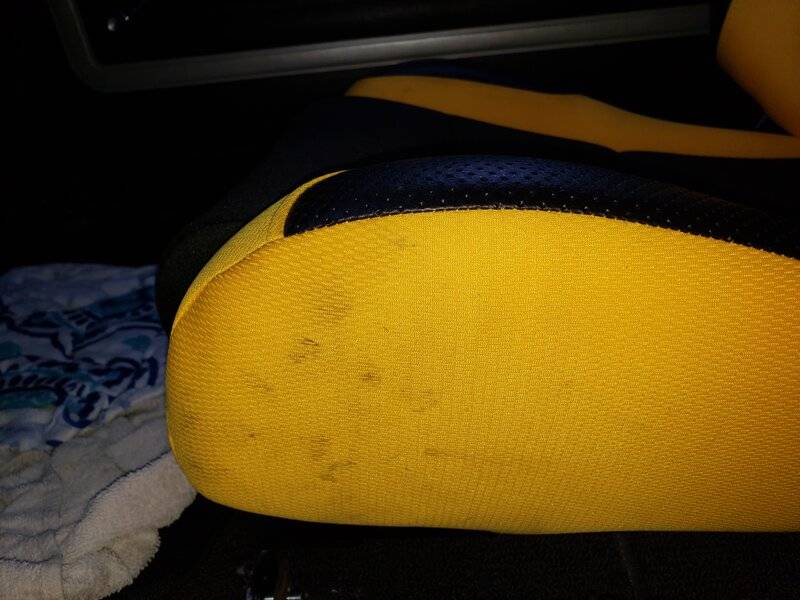

Need advice ASAP!! Shop got black grease/dirt streaks, marks on my yellow fabric seats. Cleaner??
My polyester or nylon or similar man made fabric that covers the majority of my Scat Procar yellow and black bucket seats has black fingerprints, streaks, and other grease or "shop grime" marks on them. They were out of the car for most of the shop time, but DAMN!
Anyway, I can test an "inconspicuous area" to see if there are any negative effects (other than weakening the material) of any cleaning products or techniques that may be recommended by any of you and I absolve all advisors who offer sincere recommendations for a way to clean them.

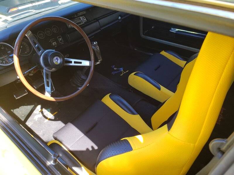

Here's a couple of older pix. Just imagine shop funk grease marks on my beautiful yellow fabric.
:mad::mob::soapbox: PLEASE HELP!
View attachment 1009576 View attachment 1009577
I use C60 cleaner by SPRAYAWAY. It works amazingly well. Good luck. https://www.googleadservices.com/pa...i3le2p36LsAhUSCs0KHeIwDasQ9aACegQIDBB3&adurl=
Good name brand electronic parts cleaner / non- chlorine brake clean , spray on clean white cotton cloth & dab grease spots - go slow, do not be aggressive rubbing it in further ! Soft toothbrush etc. if necessary, read ingredients for percoetholene ? ( chem used for dry cleaning delicate clothing @ dry cleaners ) - my go to as needed , always start with mildest cleaners first though - as mentioned 1*dawn dish soap - 2*tuff stuff foam upholstery spray - 3*wax & grease remover - 4*chemical cleaners as above , you never want to get the scrub brush and put elbow grease to it - slow and easy with clean absorbent towels and soft brush , don't soak it - take your time - keep vac handy and pull all dirt out- once dry Good ( could be the next day ?), then get a stiffer brush and open the fibers up and blend them back to original look - patience and find what works on that stain - loosen and remove it , don't grind it in ☠ - then you might want to top it w/protectant (ie: scotchguard) ? Ahhh - seat covers, blanket when going for service ?? I've BEEN ASKED B4 , OFTEN !
Super Clean carried by Walmart. Approved for laundry use. Really good degreaser.

I found some stuff years ago called "oil eater" you will have to look it up in local hardware stores.. cleaned up my fabric well and no spots or stains..

Dawn, soap, warm water
Wax/Grease Remover
Spot-Shot
All-Off
magic eraser
grease- off
Spray 9
Gojo hand cleaner
Simple Green
Krud Kutter
store brand” degreaser that the Dollar Store sells
Brakleen
Carbo-Trichlor
engine degreaser
stoddard sovent
Perchloroethylene, perc
Liquid Tide solution
brand name electronic parts cleaner.....non- chlorine brake clean
Super Clean, by Walmart
Mopar super clean
oil eater
McGuiar's Super degreaser

Forgot the best.:D Let a pro clean it.
So I guess I'll take all of that, and mix it all together, and use the resulting product! I haven't tried anything yet, but I will give a report w/before and after pix.
You know anyone, with one of those little Bissel, furniture cleaners? And if, no, a small wet/dry vac, remove bag, set up for wet service, spray a little detergent on the spot, above list, a little spray of water, agitate the spot with a small brush, spray a little more water, draw it out with the vac, repeat with water spray, and vac 4 or 5 times until detergent and stain are gone. No different than carpet cleaning.
Using a wet/dry vacuum makes sense regardless of what cleaning solution I use. Thanks
I have found that Tub O' Towls hand cleaning towls takes stains out of almost anything....and, I mean anything!!! I drug a greasy part across my truck seats...BOOM!! took it right out!! My buddy had a funky white stain on his black suede SRT seats...BOOM!!! Took it right out....these things clean your hands and, everything else!!
Tub O' Towls
I had never heard of that, but looking it up, it seems pretty effective and versatile!
So I'll take my blend of all of the things that have been suggested, but now I'll put that concoction on a Tub O' Towls wipe, because ya never know!
