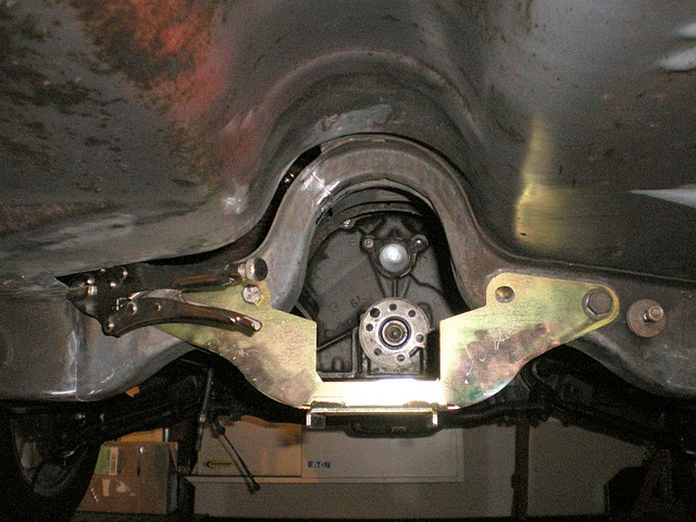

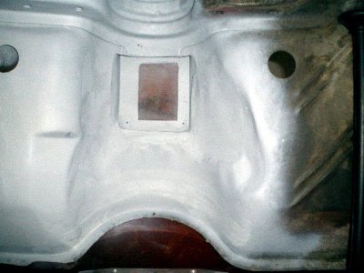

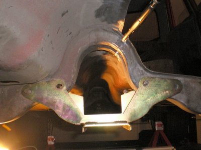

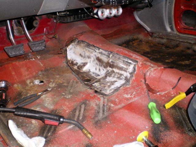

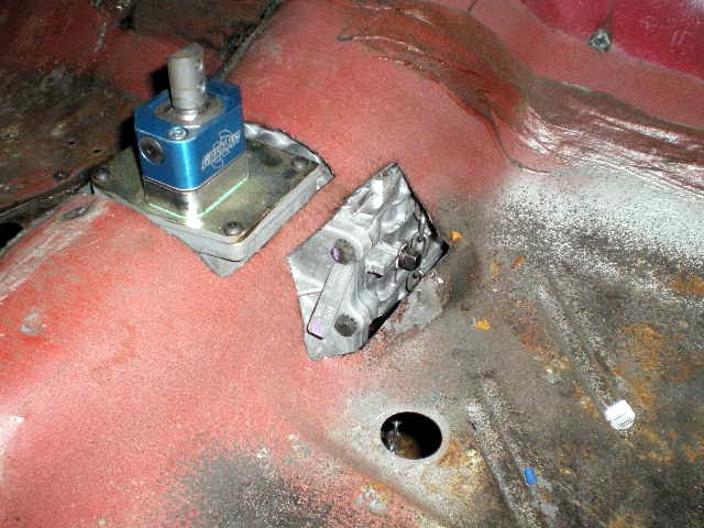

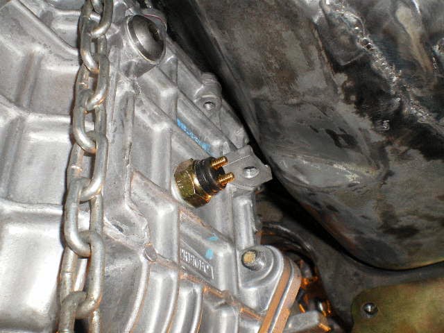

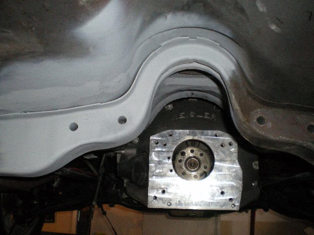

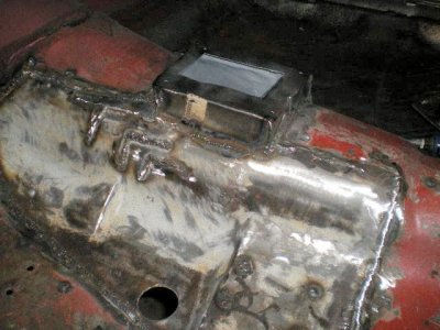

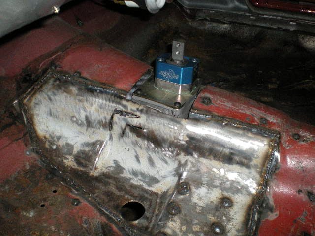

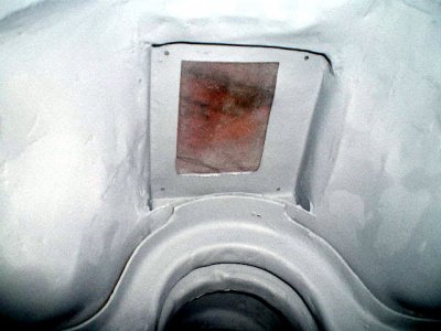

Heres some pics for ya of my B-body install

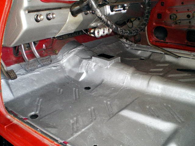

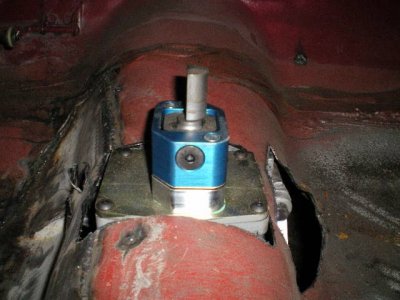

and some more for you
and again

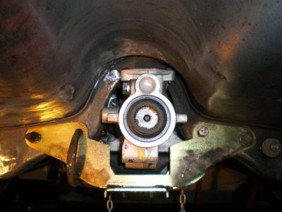

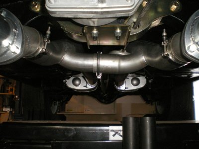

hers a pic with 2 1/8 inch TTi's and their 3" pipes

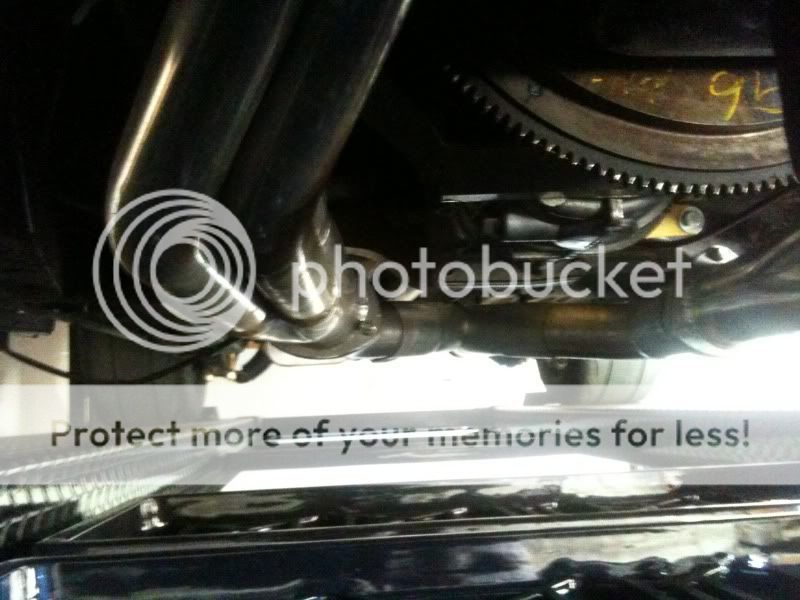

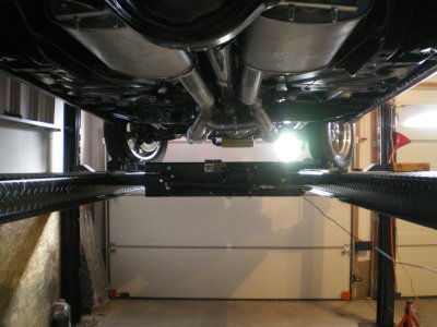

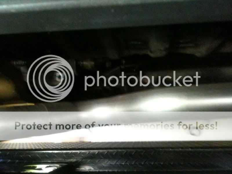

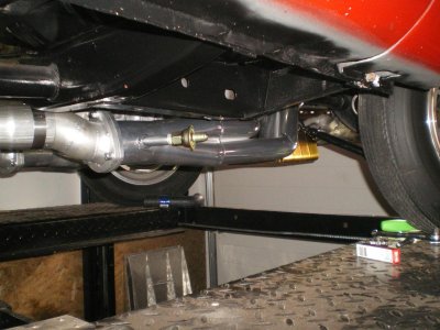

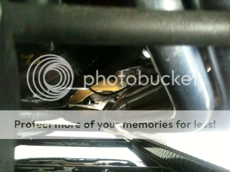

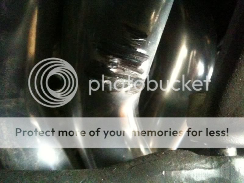

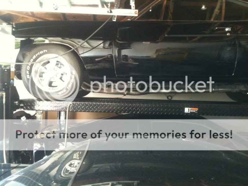

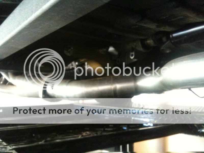

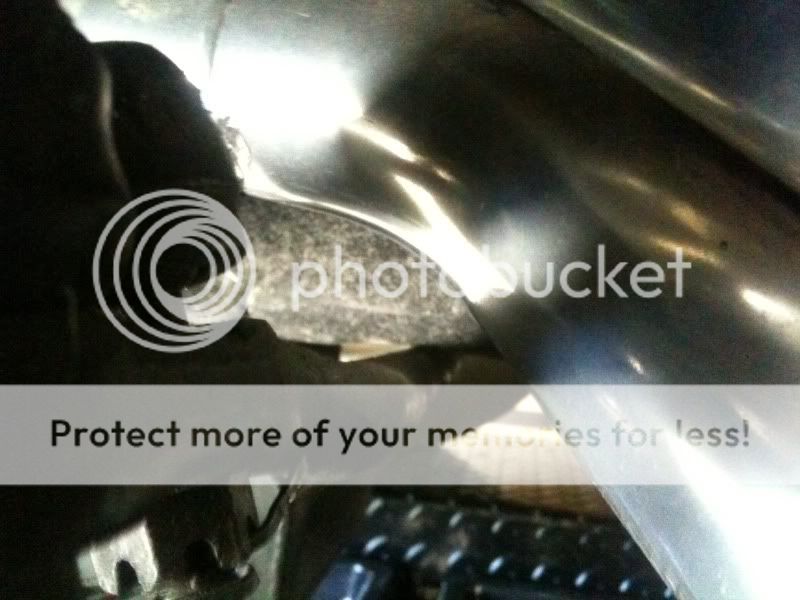

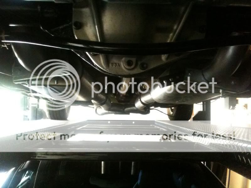

Sorry for the lack of pics I have been out of town. Anyways here are some pics I just took.
See how low the headers and exhaust hang? This was not like this before the 5 speed install.
Steering hits header, did not do this before 5 speed went in.
Center link is about 1/8" from oilpan.
Again headers are crazy low. If this is "normal" in keisler's eyes then normal is not good enough in this case. I have to lay 2x4's down to drive this car on the lift. The vette below it that is lowered drives right up...... That vette should not have more ground clearance then the charger does.
