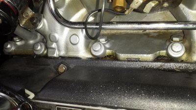

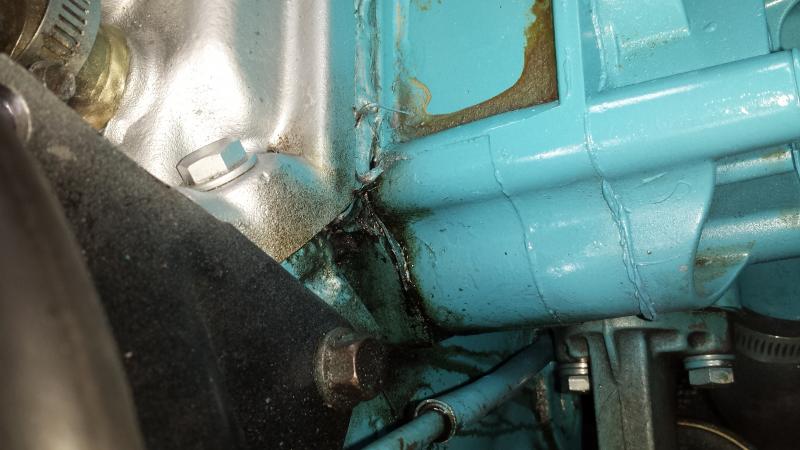

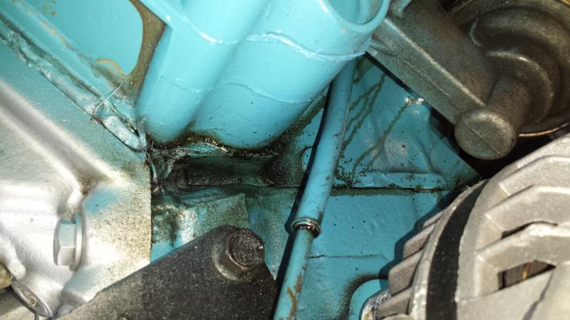

Alright, I just bought a running 360 and i'm going to go through it. Looks like the previous owner just threw it together? Says it was rebuilt a month ago, and he doesn't run it hard. Take a look at the pictures I added and tell me what you think?
I heard it run, sounded good, very lopy. ]Maybe just a valve job on the heads and a new intake. He had it in an A body and it ran low 12s. Bought it for $400.
I have gaskets from an old rebuild kit. I was looking at P4120094 Head gaskets, looking to squeeze out as much compression as I can. Also, kit came with a aluminum + Paper intake gaskets. Thoughts on the two?
Sorry for the big pictures. New to the site.
Driver side - good side
Passenger side - leaky side
What's the problem here?

Looks like you are blowing some oil out of the dipstick.
Do you have a pcv on it? Intake manifold could be not sealing. Causing pressure in the crank case. Are you blowing oil out of the breather? If so, might be time to open up the engine. If it's not in the car yet, now is the time to go through it.

Looks like it's been leaking on the driverside breather. There aren't PVC's just two vented breathers on each side. How should I find out if it was leaking from the dipstick?
I have the engine 90% apart. I don't want to pull the crank/pistons. they look good. Bearings look good, cam looks good. What should I be looking for? Don't want to swap the bottom end just because I'll be pulling the engine again when the car goes to the body shop. Just need a car to drive!

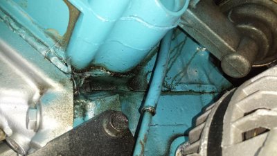

Also found a leak by the "arm" that holds the oil filter. New filter should fix that?
