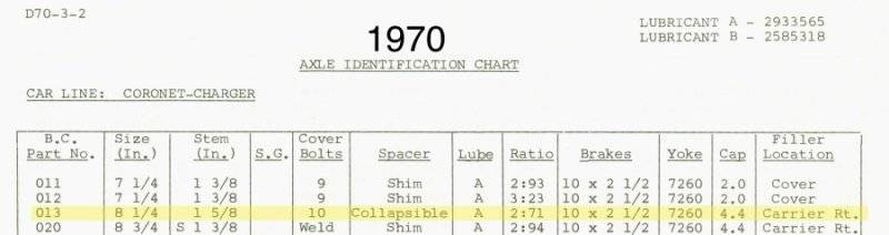

How's this?
69Coronetrt
11:54 AM
Jul 17, 2008
3,520
2,677
Harlan, IA
Here's the 1970 rear axle application and code info. Looks like it is 013.

69Coronetrt,
I would say that I would have to agree with you on the "013". everything matches up in your table with my car including the collapsible spacer.
I found a "1" stamped by the brake line mounting point (LH side, forward). It was too rusty on that side to axle for the rest of the numbers to survive.
On the right side facing forward are these numbers, which still have me guessing. probably the final assembly date, which should have been in May 1970.
