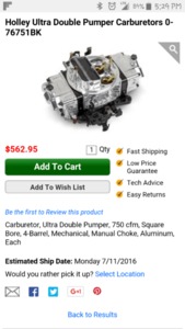

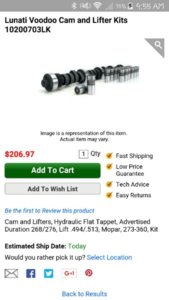

I don' feel that something is right. Not to knowledgeable and need guidance. Engine shakes really bad sometimes during idle. I know I may need to take a look at replacing motor mounts. Had the engine rebuilt a year and a half ago (360). Aluminum heads & the below carb and cam. This is in a 68 Satellite.

Might not solve your shake but that double pumper might be a bit big for that motor?

Thought so too on the size of the carb. We jetted it down.

Okay...First up: That carburetor! A 750 double pumper carburetor is too much for a street driven 360 automatic car. Unless you drag race the car, the double pumper throws TOO much fuel into the engine. Jetting it down is a crutch. The issue is that it is a "double pumper" design. These have mechanical secondaries and an accelerator pump for both the front 2 barrels and the rear 2. A 750 Vacuum secondary carburetor would have been about $150 cheaper and ran a bunch better. Here is why: For street use, 90% of your driving will be at low rpm and midrange. During this type of operation, the vacuum secondary carburetor acts as an "on demand" device. The engine only gets what it needs. Under about half to full throttle, the secondaries open and then you get the full 4 barrels. The double pumper (Even if rated at the same 750 CFM) dumps fuel whether the engine "needs" it or not. Over time, the excess fuel goes unburned and fouls spark plugs, forms deposits on intake and exhaust valves and causes carbon buildup. In the worst case scenario, the unburned excess fuel washes oil off of the cylinder walls and causes early piston ring scuffing and wear. The double pumper carburetors do work great in a drag race engine, since they operate at wide open throttle at almost 100% of the time.....down the track!
