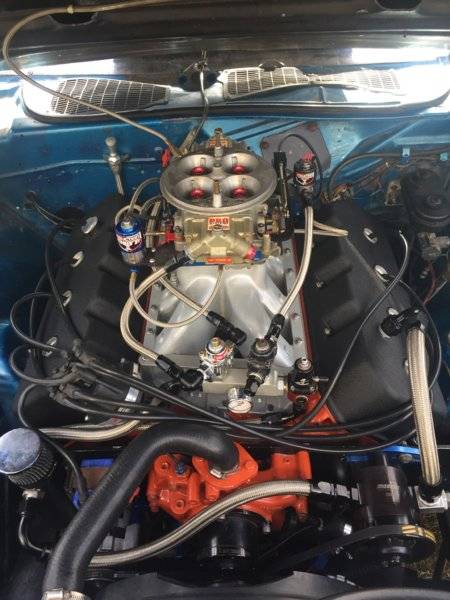

malex...it's a 575" pump gas hemi, cnc ported MP heads, fairly mild solid roller, single dominator, 727 trans, Dana rear and Cal-Tracs, 295-65 ET Street radials, KB block, Callies crank, Oliver rods, Diamond pistons, etc.
Has been 9.54 at 140.4 mph at 3800 lbs all motor and on pump gas.
It's been high 8s at 152+ mph on nitrous at close to 3900 lbs.
Here's a pic

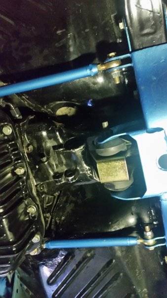

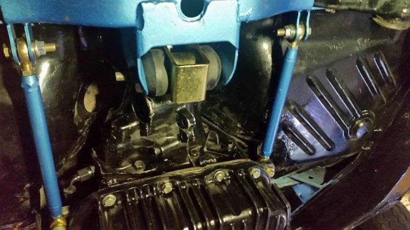

The struts sure look like a good plan, I think you can fit both sides. My tube chassis Arrow used a CM tube trans cross member & the 727 bolted directly to it, no "trans mount". Seems like the struts are trying to duplicate a "solid mount". Don't think the suspension motion is an issue. Motor plates & mid plates sure will flex. Fore/aft motion needs to be controlled.
I like this design. The struts mounted to the lugs take the stress off the rear mount and housing while taking the flex out of the motor plates. I can see the limiters on the 64 getting moved back, a few lbs moving to a better location.
I was under my car the other night and decided to take a picture of mine while I was under there.
