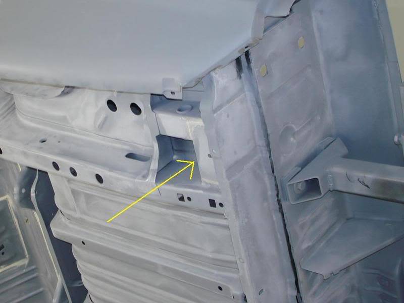

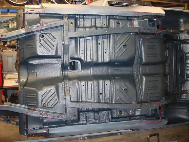

It would appear that nobody has pictures of the 73-74' locations. Here's a 72', it's been many years since I've laid eyes on torque boxes on a 74' b-body but I don't recall them being that much different from the 71-72's.
For 71-72' there were box plates near the shackle pivots that were part of the "U&V" code body reinforcements.
Thank you very much. Those Boxes look Identical to the ones I bought for the 74. I will get these pics to my Paint and Body Guy ASAP. Again Thank you. Went to the shop today, the car is in Total primer, he is hoping to get it wet sanded and Painted before the Christmas Holidays. Will get some pics up as soon as I figure out how to.

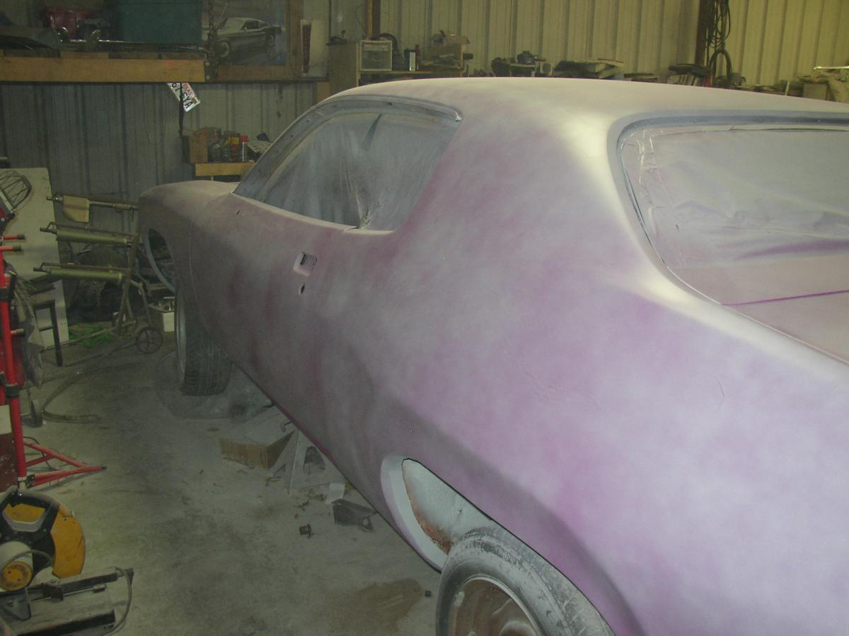

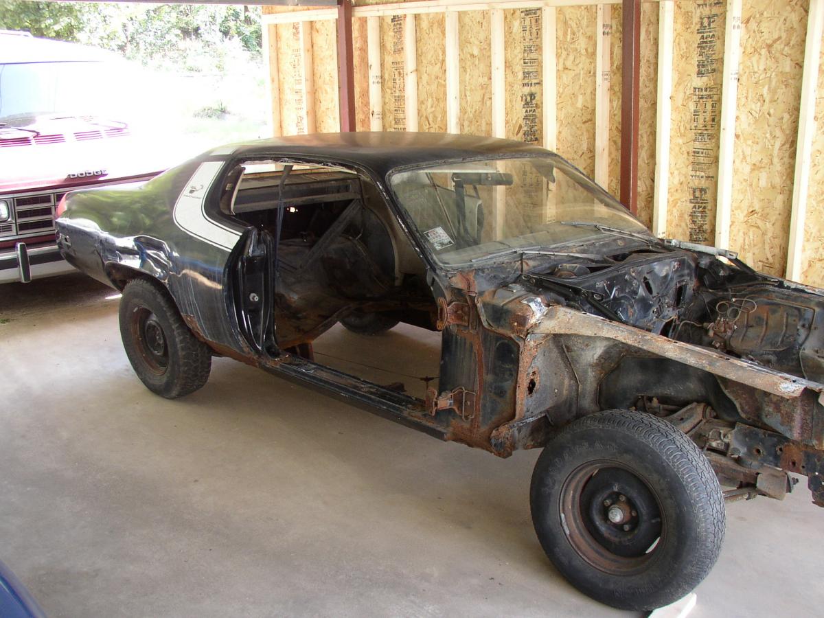

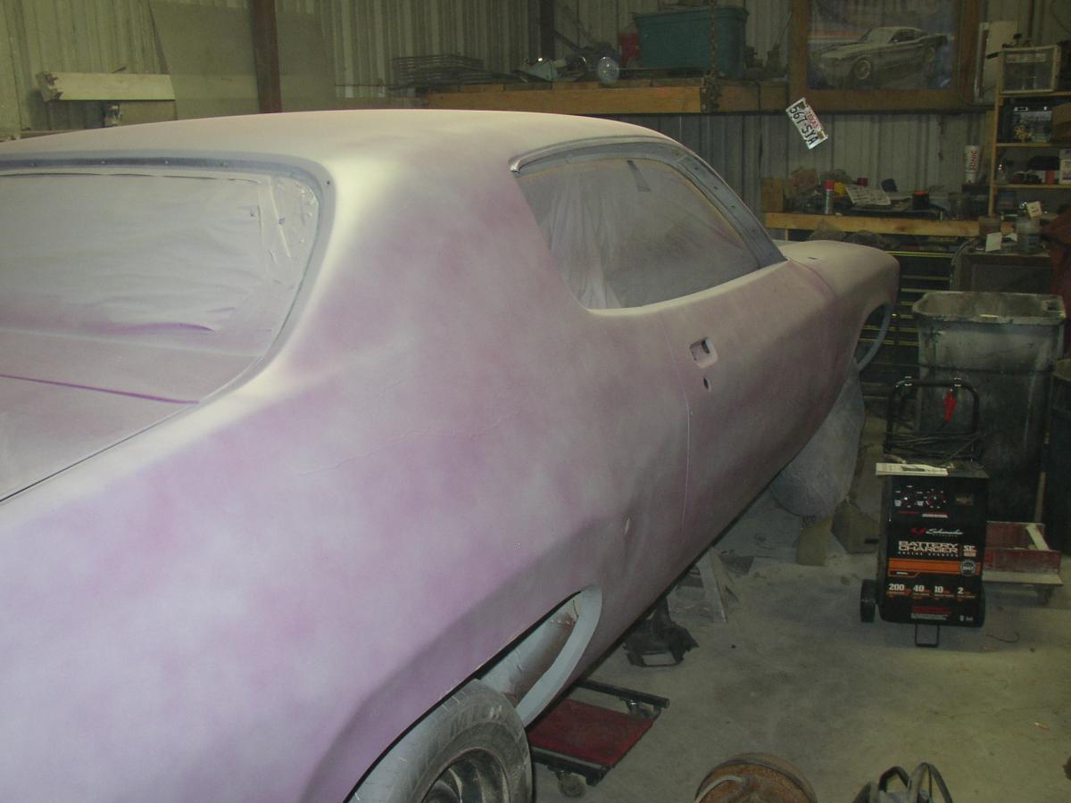

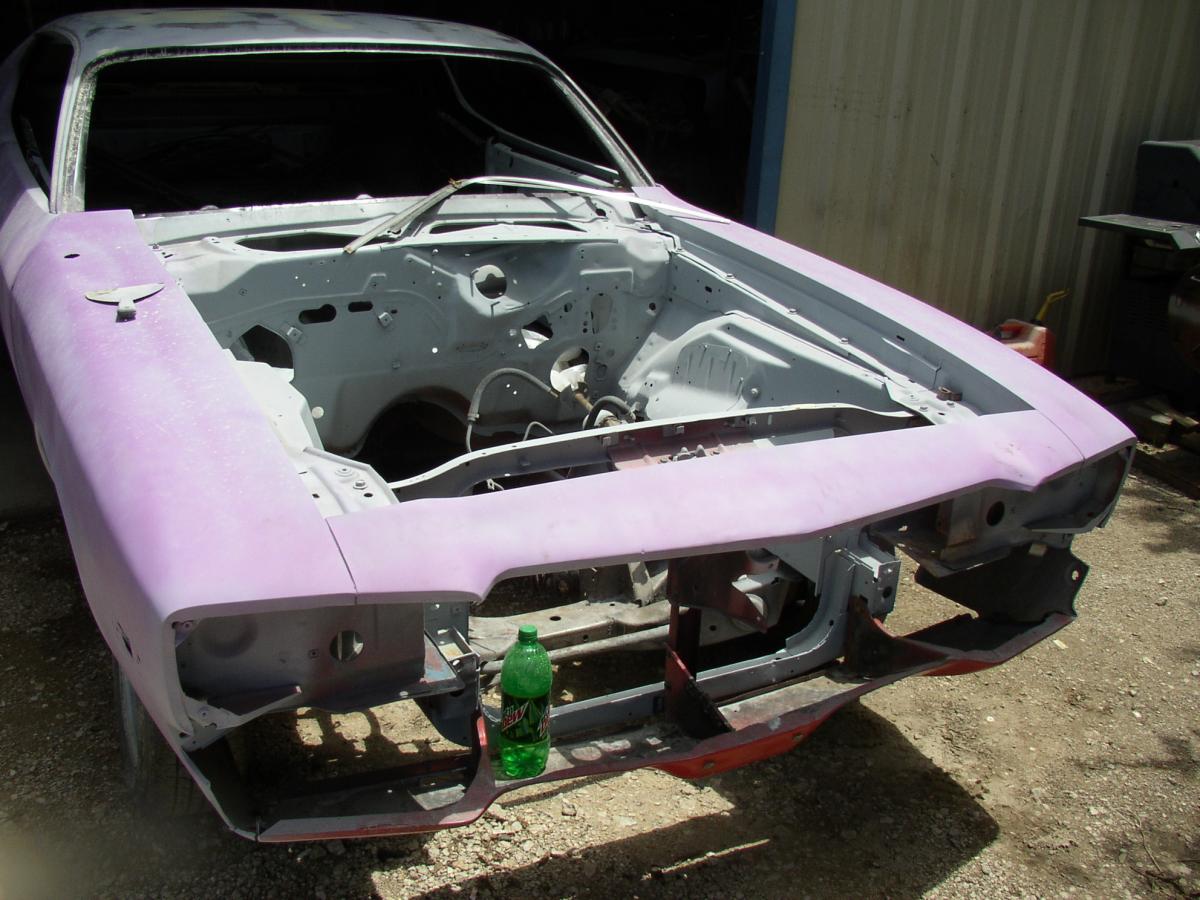

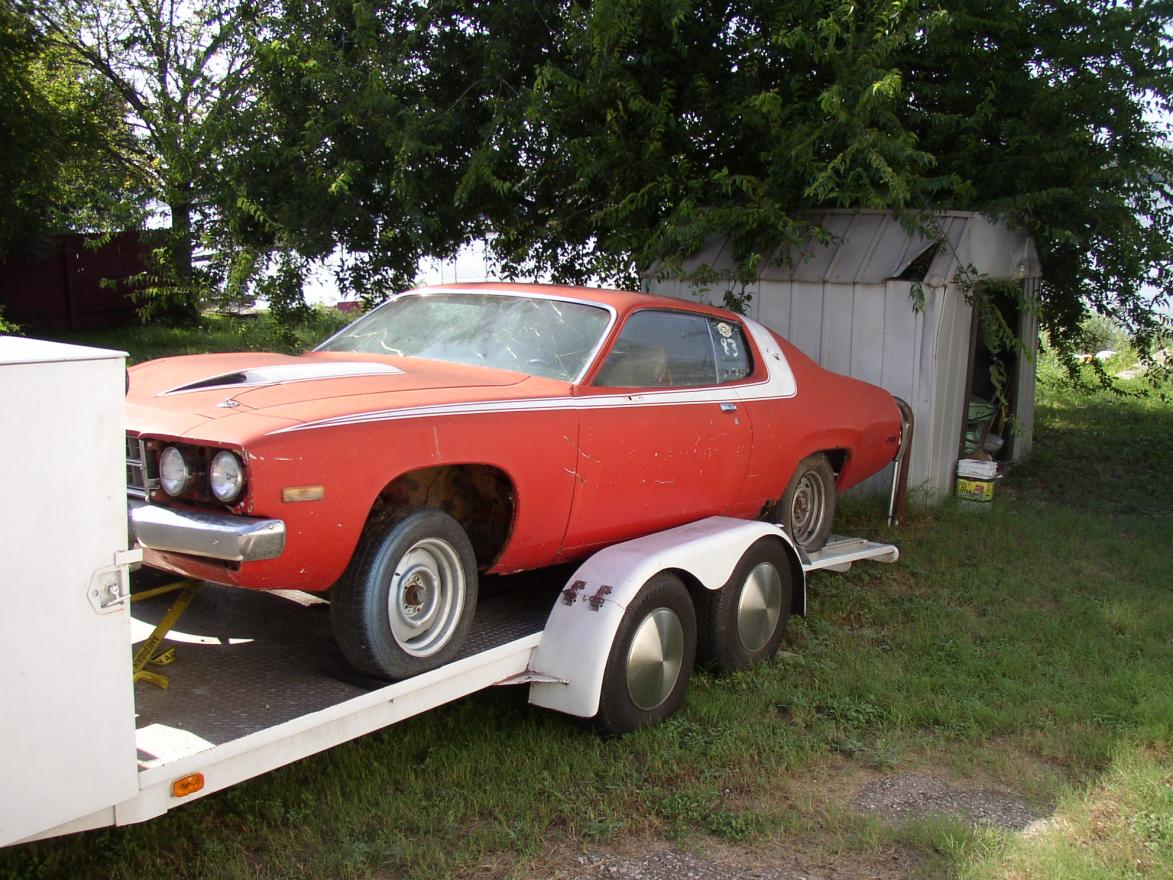

Some Pics
Here are some pics from the beginning. 1) The GTX as I received her 2) The RR Donor car that I bought with the GTX $2000 for Both. 3,4,5) Various stages of primer, the last 2 taken today
Clay
