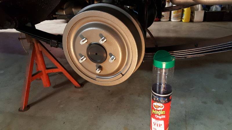

You don't need a helper, you don't need to spend money on a fancy gadget.
Get yourself a container to catch the fluid and the proper size hose. Make sure there is fluid in the container and the hose is submerged. As long as the hose is submerged in fluid, it won't suck any air back into the system.
Bleeding order...
Right Rear
Left Rear
Right Front
Left Front
In that order only. With the hose submerged in the fluid in your container, crack the bleeder open and pump the brake pedal slowly. Once the pedal is down, let it back up slowly. Do it twice and then tighten the bleeder. Move on to the next wheel. Check the fluid in the master cylinder periodically so it doesn't run dry. If it does you'll have to start over.

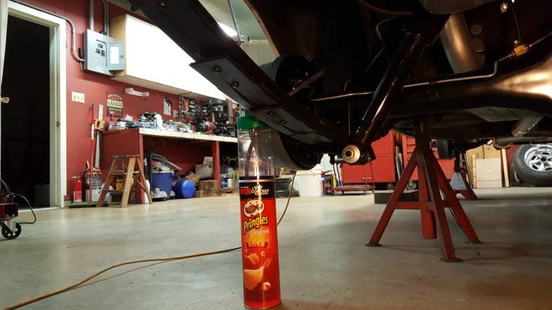

Made one from a cheese bottle, stuck it into a Pringles can. I placed some chain inside of the Pringles can for weight so it doesn't fall over.
This is how I did mine after I did my conversion... Works great and no mess and no helper (unless you just want some company).
