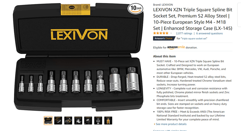

I regularly work on a 07 VW Eos 2.0T and it should be straighforward. The only odd tools you MIGHT need are the "special" VW star sockets. They are NOT torx-head, but truly VW/Porsche only. They are called "triple square" because they are literally, three squares offset. You may not need them, but if you are going to do regular work on your VW, get a cheap set. Here are the Amazon ones I have:
Good luck,
