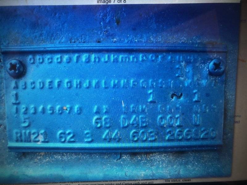

Going to look at a 1968 Road Runner tomorrow. I have a picture of the fender tag, but the online decoders are not giving me much information. Can someone on here decide it for me ?
Would also like to know where to find any other identifying stamps in the body that would verify the it's a true Road Runner.

On the lower right of the fender tag the will be a set of numbers. These are the SO #s and you should find it stamped on the radiator support on the drivers side ahead of the battery tray. You should also find it stamped on the rail of the trunk lip on the drivers side halfway up the trunk opening. It will be partially or completely covered by the weatherstripping. The VIN should start with WM. There may or not be an SO # stamped on the engine block on the top rear in the area of the oil pressure sending unit along the lip where the bellhousing meets up to the block. There is a pad on the block under the distributor that should have D383 and an HP stamp on it for a 68 motor. Hope this helps...
Fender tag below. I've tried to use the on-line decoders, but had a hard time with aligning the information into the de-coder.

Bottom to top:
RM21= roadrunner coupe
62= 383 4 barrel
3= 4 speed
44= F70x14 RSW steel belted
603= Scheduled production date (June 3rd)
266826= Vehicle sequence number
Second row up:
5 under the 2= Drip rail mounding
6 under the a= 355 gears
8 under the X = sure grip
D4B under the TRM= Deluxe vinyl split bench light blue
QQ1 under the PNT= Bright blue metallic monotone
U under UBS= Light blue metallic upper inside door color
Third row up:
1 under the A= 26” radiator
1 under the R= AM radio
1 under the X= tinted windows
Top row:
1 under the U= Car was ordered as opposed to dealer stock
Thanks vintage chromoly!
