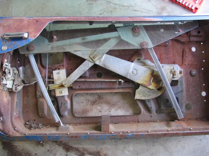

This is probably the best pic I have that I got from another thread on this forum or one of the other mopar forums. I hope it helps. Like the other guys said, only do one door at a time!!! The channel that attaches to the glass is really the only part that can be bolted on either door and it will bolt up corrrectly. But you won't find out till later that it doesn't really work and the regulator will pop out of the tracks with the window all the way down leaving you wondering what the hell is going on. Don't ask me how I know, lol.
