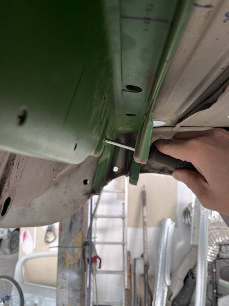

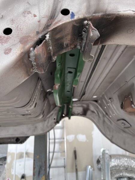

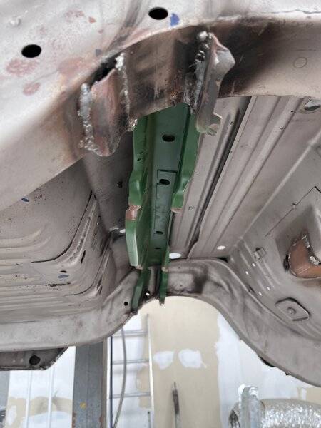

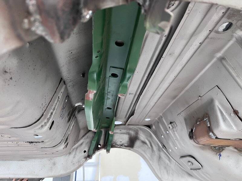

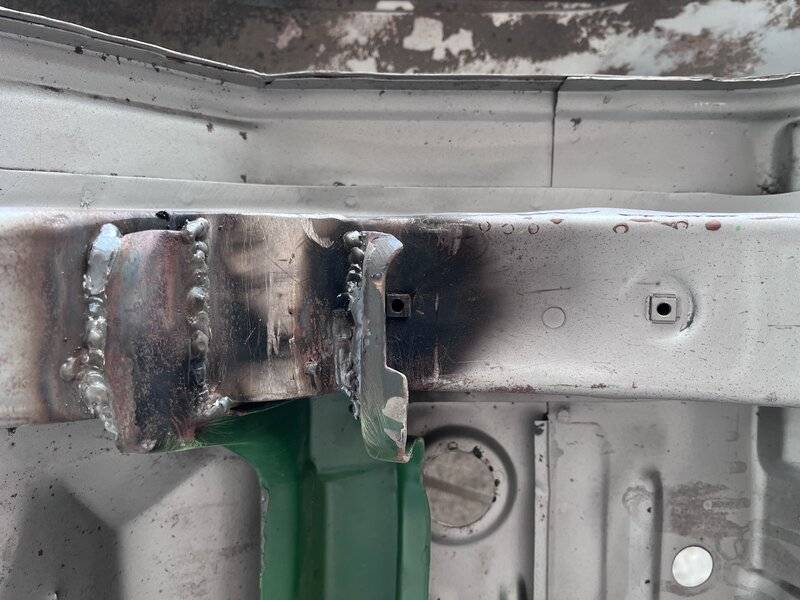

Hello, I need your help, maybe you can help me to better pictures for rear shock crossmember… it is 68 Coronet R/T…
anyone has remove the crossmember and my worker has put in the, but it isn’t straight down… with a Little Angels… See pictures… please help me with Details pictures and measurement…

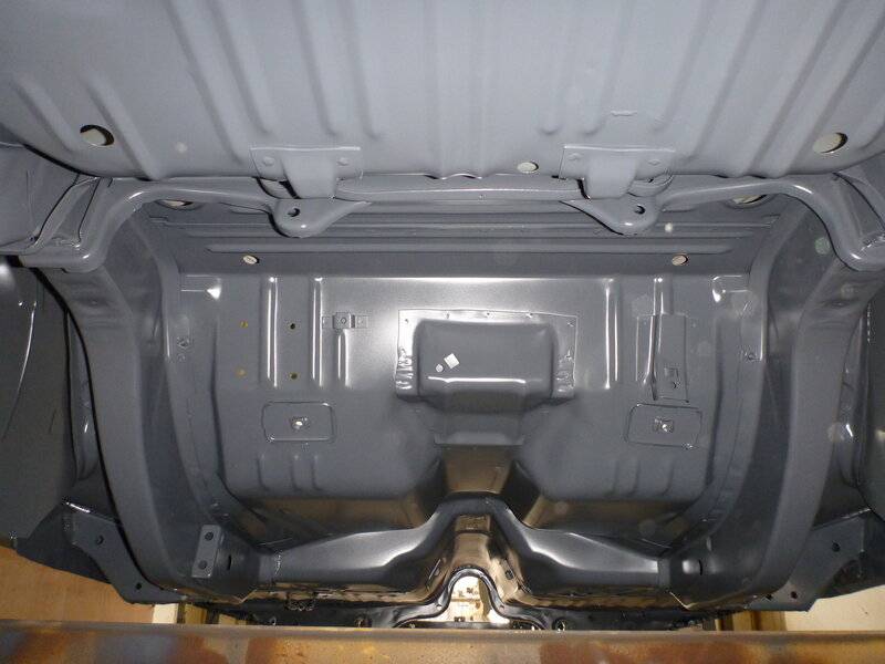

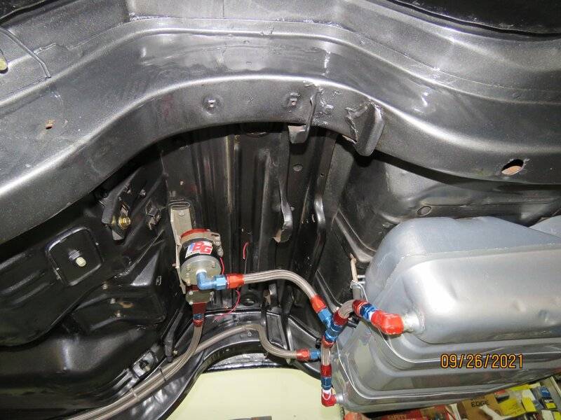

Sorry, best I can do from my build photos. I'm not un-stacking my cars to get you measurements! Hopefully one of the, many, FBBO members that has a body on a rotisserie can get what you need...

It looks like you're about an inch too far forward...
