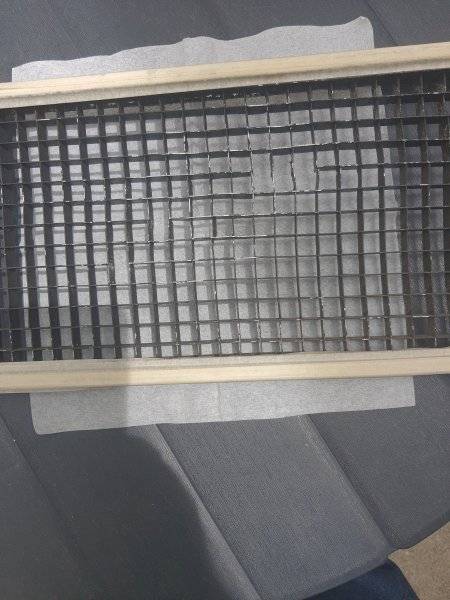

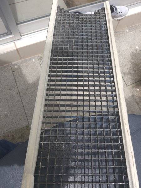

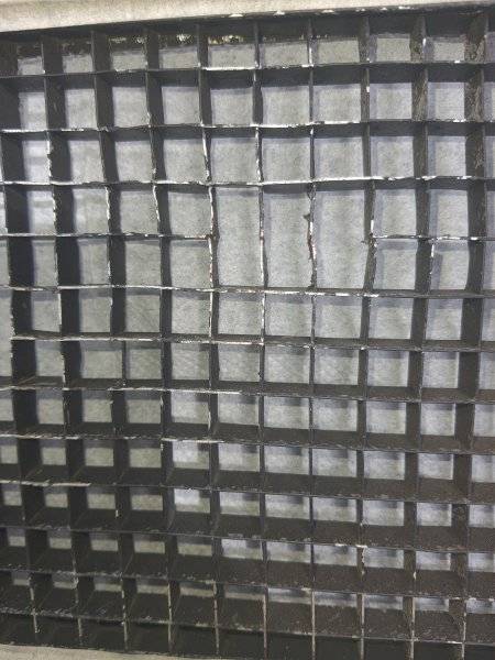

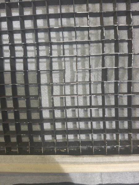

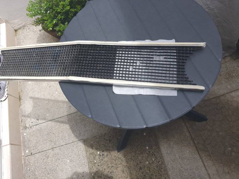

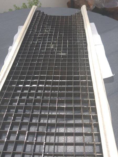

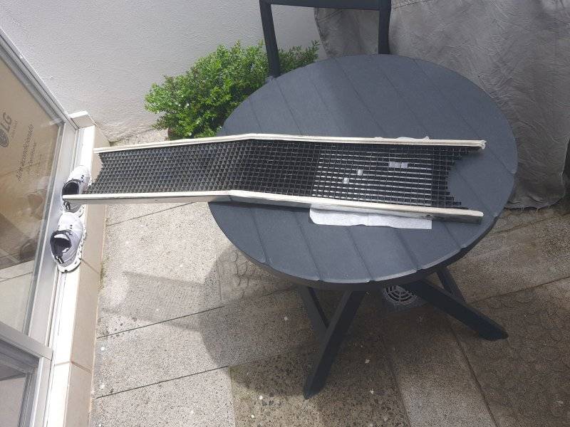

I decide that is time to move my *** and restart my car with small parts that need a lot of attention, this is my grill, one side is perfect, the other not so much, a few of the fins are missing and I can't find an specific tread about how to fix this particular problem, any idea guys? apparently someone before me try to fix it, buy a new one is out of my budget, so any help would be greatly appreciated, thanks in advance.
You need to find an old grille with like materials. Bonding agent is made from old grille shavings and acetone. You mix the acetone and grille shavings in a jar and it will dissolve the shavings into a paste. You can then use the paste to repair or bond pieces. The mixture will bond like no other into the grille you are repairing. Let it fully dry and cure and the repair will be as solid as the grille was new. You can then grind and file the repairs. Then you can refinish it. Buy some acetone and shave some pieces and you can see what consistency the paste will be before starting to make repairs.
Thank you so much I've never heard of that before, the fins looks like an aluminum like material .

I’ve seen guys use the diffusers for lights to replace entire sections of grill. It is plastic, though. Also, some of our buildings have metal grills in the heating/cooling ducts that look very similar to what’s in your grill.

This is an interesting idea the mayor problem would be the size of the squares, one side is In very good shape the other not so much as I state and it's the original grille,
