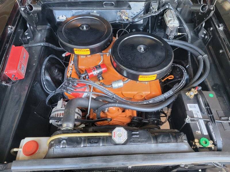

Hi guys,
I have a 1965 Satellite with a 440-3 out of a 1974 motorhome. it has the 213 heads that take the 5/8" peanut spark plugs.
I have been having an ongoing problem for as long as I can remember where the car idles great, sounds great, drives great, but when accelerating heavy or WOT is sputters and jerks then it will eventually clear up and take off.
here are the specs:
440-3
MSD 6al with pro billet distributor with 1 silver spring, 1 blue spring, and the black bushing with initial timing at 18* for a total of 36* all in around 2000 to 2500 rpm, MSD Blaster coil, Taylor 10mm wires, and NGK UR5 spark plugs. (have tried ngk, champion, autolite, and bosh plugs with no change in acceleration).
A&A transmissions brand cross ram manifold (426 Super Stock tribute) http://www.aandatrans.com/Products/...ake-Manifold-(As-Cast-Port)__RMWACRIM-14.aspx
2 Edelbrock 500 cfm manual choke carbs (have tried all 3 accelerator pump positions)
Lunati cam lift .465"/.465" advertised duration 285*/300* duration at .050 tappet lift 228*/235* https://www.jegs.com/i/Lunati/638/33702/10002/-1
213 heads surfaced and shaved
timing gear drive
bored .060 over
compression 9.25:1
Napa brand flat top pistons
hardened valve seats and high pressure valve springs
30/30 crank grind
Hedman headers
I cant seem to find the happy place for timing or maybe this is not a timing problem at all? Maybe too much carburation for this engine? Exhaust smell at idle is a real eye burner even though it idles great.
Any help would be greatly appreciated. I might be able to get a video of the problem tomorrow if it would help.

I got it running like it's never ran before! I put on a set of MSD street fire spark plug wires and reset the carbs back to all factory settings. I then slowly adjusted both carbs equally using the idle mixture screws. Ended up at 1.5 turns out. I then set the idle with the primary idle screws. I also found that my number 6 plug wire had a loose terminal at the plug end and I thought I had the blue and silver springs in the distributor but I actually had the light silver and heavy silver. I switched to the light silver and light blue and double checked that my initial timing was at 18*.
Now it runs like a race car! I couldn't be happier. I will still get the carb synchronizer to fine tune it though.
