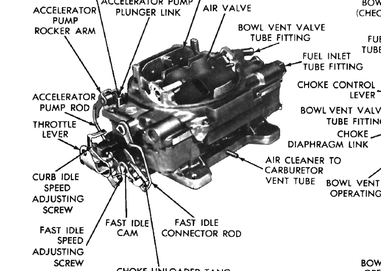

there were some questions regarding adjusting the power valve. The diagram shows the accelerator pump rod and I simply adjusted it to the top level to extend the travel to maximum.

“I believe it's an Eddy carb”
You 100% positive ?
Picture is an Carter AVS that you are showing
And there is a huge difference between accelerator pumps and material
A Start
If its the factory carb for a 71 GTX U Code 440HP
Carter AVS 4968 Auto
Carter AVS 4967 Manual
We would start with the leather accelerator pump LIKE MENTIONED , especially if the carb has been sitting for an extended period of time
