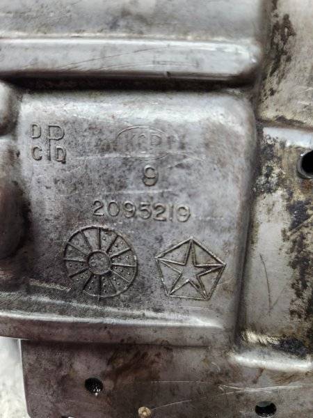

This is the old starter I took off. Napa seems to think it is a marine starter.
