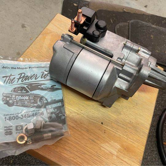

When I looked the 244-1083 number up napa showed a picture of the OEM mopar starter. If it was the lightweight version I will bet that that hard plastic wiring lug was on it and the starter was not fitting into the bell correctly.
What is a hard plastic wiring lug? That might be the problem. Do you have a picture?
Was yours like this?
Weird question but it's not a smallblock with a 904 trans and a b&m flex plate?
That's the only case of that starter not working with the combo that I've heard of.
Probably 50% of the time on a bigblock, there's interference on the starter housing to the inner U of the block. Clean it up with a mini die grinder and carbide. Check the starter sits flat and square to the trans without obstruction from the block.
And yes with our supplier they send you a new style starter at the old style prices. About half the cost they should be . We love it.
I removed that black piece and hooked wires where there are two more lugs. Nose of starter was tight, Before you hook battery check copper lugs aren't hitting hlock, sometimes they need to be trimmed. I slid a piece of cardboard up behind starter to make sure nothing touching block.

Took off the plastic cover and bolted the wires on the starter and fixed it. Thank you
