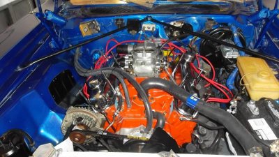

cool thanks i am going to the shop now and will inform my dad. we also think it may be the headers they are riduclously hot cant even touch the firewall. the ole man picked a bunch of asbestos wrap so he will arap the headers also he is replacing the fan right now it has a clutch fan. thanks for the help and i will keep you all informed of the progress will attach pics aswell

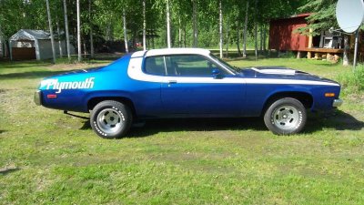

some pics
1973 340 rr
