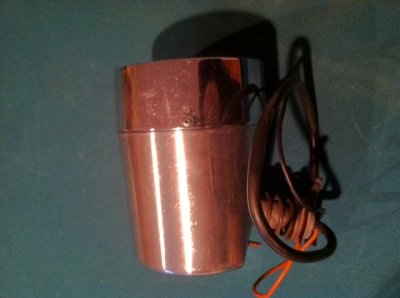

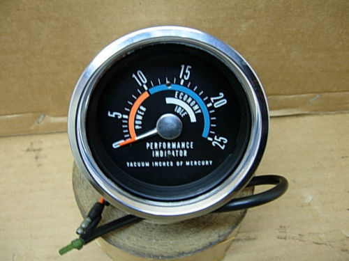

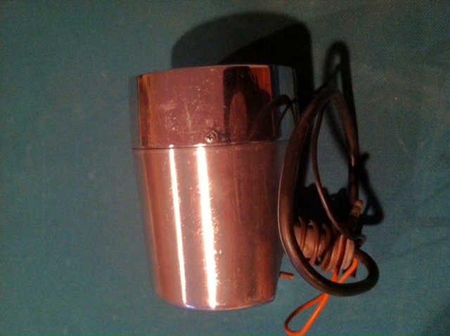

I just pick up a 1966 - 69 MOPAR ORG CONSOLE VACUUM GAUGE PART NUMBER 2631880.. I would like to mount it on the steering column. Need vacuum routing, connection info & wiring.. Thanks.
simple hook-up...vacuum line from gauge goes to intake manifold
wires are for light bulb...orange is power, black is ground..
