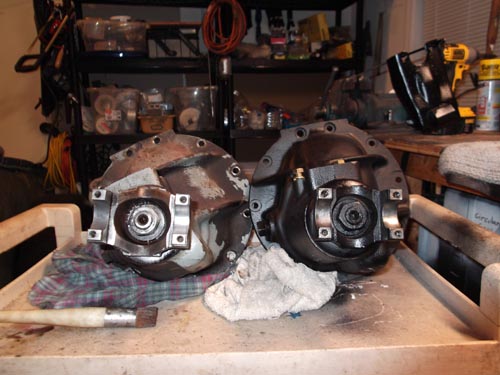

Univeral Joint Problem, need your input
Artie
Need your input…….the new differential axle Pinion that’s on the 3.23 differential is too small for the universal joint. Can I take the one off the differential I just took out and put it on the 3.23 differential so the universal joint fits?
If so is it just an easy change-out….or do I need to do anything special?
Also, the differential that I took out (which I thought was a 3.91) is a 4.11; no wonder the RR was screaming at 65mph.
Thanks
On the left is the 4.11 (old differential) on the right is the 3.23 (new one), my question is ….the 2 parts I have circled can I inter-change them?

Frank, Read the above post's I wouldn't change the yoke it would be easier to change the ujont.and besides you don't wont to take the chance of changing the pinion depth? then you will have a noisy rear.just set that one on the shelf you my wont to put it back in sum day.or I'm sure it will be easy to sell.if its been untouched..........Artie

frank did you read this.the ujoint has both sizes one large and one small.it will go in your shaft.mybe im mising what your tring to say.let me know and will get you going................Artie

What is the case number of the new chunk? If it's the 89, you have to deal with the possibility of crushing the crush sleeve more than it needs to be and that will put too much preload on the pinion bearings. I've done it many times but I've been working on rear ends for a long time. Anyways, there are 4 different yokes for the modern times...you just found 2. The other 2 are made up with different spline count but both are the same size yokes. There are only 2 u-joint sizes and but both come with different splines. If they are not the 89 cases, you can pull the nuts and washers off and check the spline count. They will require an impact gun tho....and the adapter U-joint isn't a bad idea either but I think they have became kinda pricy.
Changing yokes will not bother pinion depth. Pinion depth is set with the rear bearing. Bearing preload is set with either a crush sleeve (89 case) or shims (41 and 42 cases).
Changing yokes will affect preload,even if torqued to specs,no two yokes are identical in length,a few thousands will affect preload.
On a 41 or a 42 case, how does the yoke affect preload when the shims are behind the the front bearing? Also, on the 89, how would the yoke affect the preload when a crush sleeve isn't crushed any further than it was in the first place? The yoke can be a mile longer and it won't affect the preload.....think about it....
