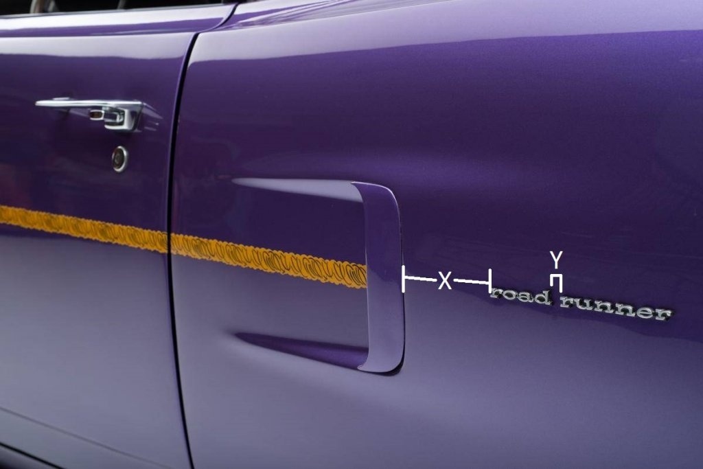

I need the measurement of the Roadrunner nameplate location on the quarter panel of a 1970. The distances back from the side scoop and the space between Road and Runner X and Y. please see attached Thanks
View attachment 367239 I need the measurement of the Roadrunner nameplate location on the quarter panel of a 1970. The distances back from the side scoop and the space between Road and Runner X and Y. please see attached Thanks
4" from the edge of the pot metal scoop. 1/4" between road and runner
