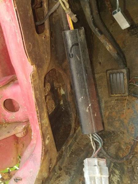

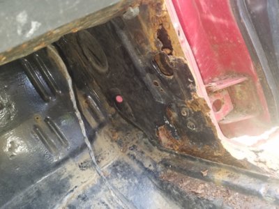

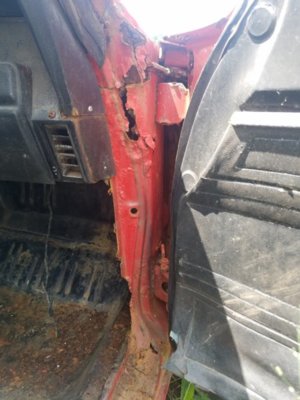

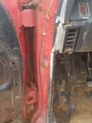

Hi Flypaper,
Here are some pics of the rust. as you can see, the passenger side is quite bad. I have the inner AMD panel. The driver's side is not as bad but I might go with a replacement one there also as it does have a bit of bubbling and some issues down low. I have to break loose the lower section regardless as the rockers need replacing on both sides.
You can see why I am careful opening the right (passenger) side door.
20190604_101652.jpg 20190604_101658.jpg 20190604_101755.jpg 20190604_101815.jpg
at that point I would just replace the whole thing
seeing that you are also busting out the rockers
mine were more rusted on the firewall side.
