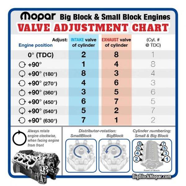

I posted above the procedure to set them
Missed that post last night somehow. Found the chart as to how I did it with solids. Your way seems easier to keep track of.

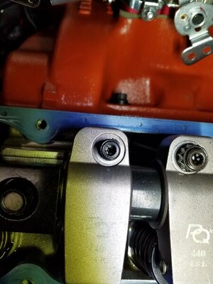

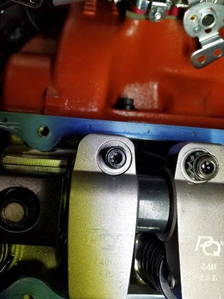

I believe you guys are on to something here. Check this out. You can clearly see the nut marking the rocker on the lower side but not on top.
That’s pretty typical of those rockers. Those won’t stay tight like that. You need to spot face them. They also exert a bending force on the adjuster which isn’t good at all. Typical Chinese quality. This is why a “well built” engine of this type is 25-30K. A high horsepower race engine is more like 50-75K.
I would seat each nut several times to see if they change. The one you are looking at may look that way as the nut may not of left a full mark as it was not fully tightened. I would not worry to much about this unless it happens after you have made sure they are tight.
I used to do it this way to. However most smart guys [not me], Cam companies as well as engine builders prefer the way I posted. They claim these cams have had profile changes in design so the old chart method can be inaccurate. They claim the cam may not be on the back side of the base circle which will result in an inaccurate setting. Especially in cams with more lift and duration changes from stock. Having a helper bar the motor over will help. I use my remote start button.
