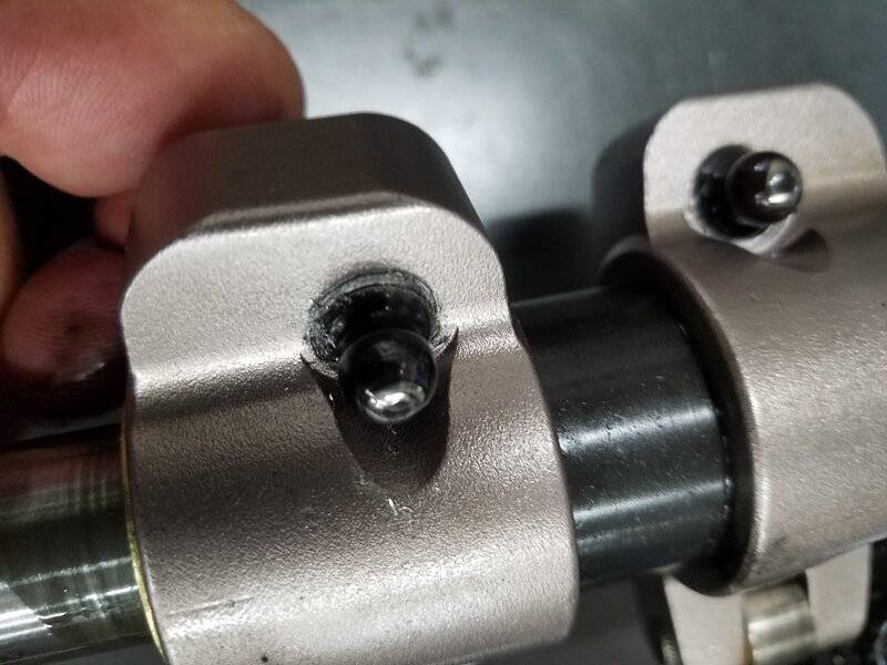

It’s like....... which of these scenarios causes you less concern......
-a bunch of rockers weren’t tightened properly during assembly, or
-the adjusters aren’t square to the lock nut spot face, so there’s a fair chance they’ll loosen up again.
I think if you check and see how easily(or how hard) the locks nuts can be broken loose after you’ve tightened them yourself...... it may help answer the the question.
