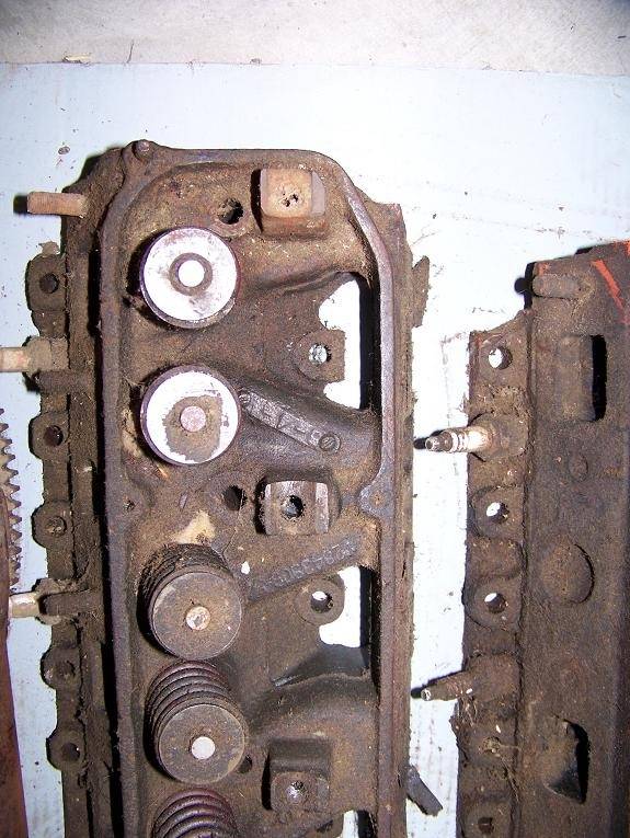

not 506 it is 906...2843906....The date stamp see pic below...906 is the correct head so once valve covers are on no one will know the date..

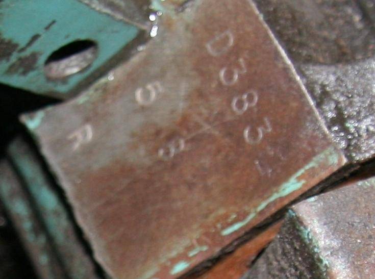

what is your cars build date? Is 5/17.67 the casting date on the block? The key important stamp is on the stamp pad should be D for 68..See pic below

The ID stamp pad will have the assembly date as well along with the "D" for 68...Also is there a vin stamp on the block where the trans attaches to the block?

yes, the 5-8 on the pad is the assembly date for that engine. what projected build date is on the fender tag? as long as the last eight digits are on the driver side rear lip of the block with corresponding number on the transmission where the two meet, you got it made. Heck, with a 68 charger any engine is good! I have had mine since 1985.

That's not his pad....that's an example of the net...

No worries....I have been waiting for him to get a picture of the ID pad and if it has a vin.....

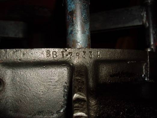

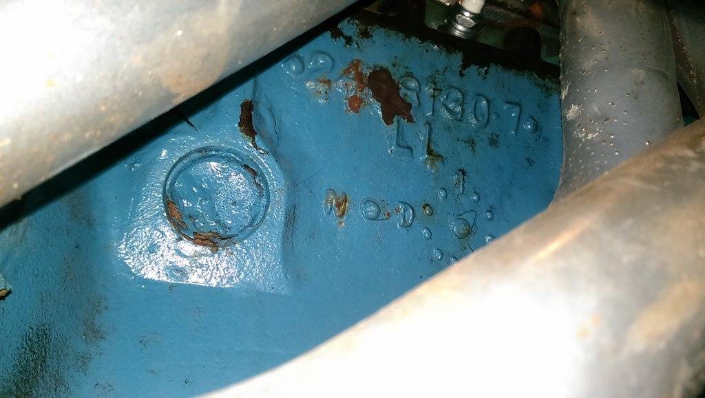

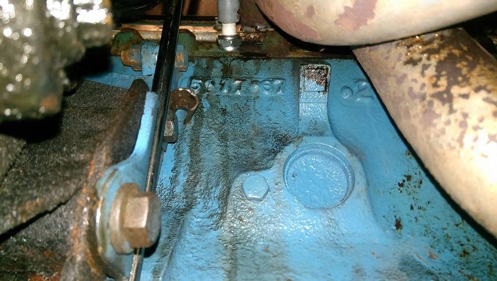

Hey guys. Went down to the shop to see my car on the lift. Waiting for the springs to come in. Met the mechanic working on my car. Worked for Chrysler for 30 years. Here's the bottom of both sides of the block as well as the rear. Will get pic's of the trans & the pad next time I go there as they didn't come out.
Are these the #'s I need to use to see if the car is #'s matching or not? Somehow I think these are just the part #'s.
Replaced the all rockers and lifters to match the performance parts in the car. Found out I have a Purple Cam as well.
Thats the blocks casting date 5/17/67
Did you not read a previous post on where the vin # is stamped on a 68 block/trans...ITS BEHIND THE OIL SENDING UNIT by the firewall...(see pic below)

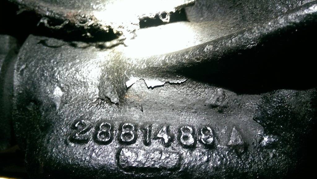

8 3/4 pumpkin is the part number...referred to as the 489 case...Best case to have it has the largest pinion...
