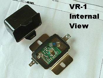

Electronic Voltage Regulator Upgrade for Early Mopars
Convert Your Charging System From Analog Points Regulator to a Fully Digital Unit
Upgrade your old mechanical regulator with
this slick retro fit, fully electronic unit.
Direct Plug & Play with no wiring modifications.
3 Year Warranty!
When you change from points to electronic ignition this upgrade is a must!
Correct many of your charging and electrical issues...flickering lights, dead battery's, ECU Failures, Coils overheating all with this upgrade

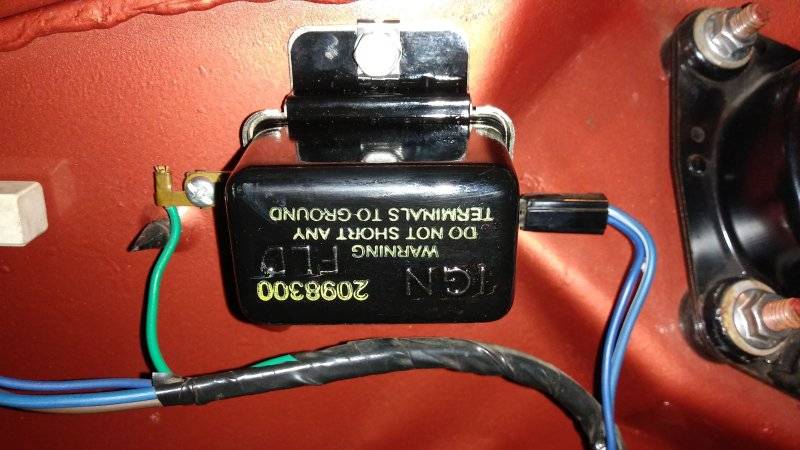

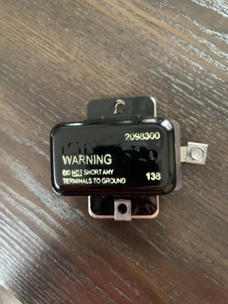

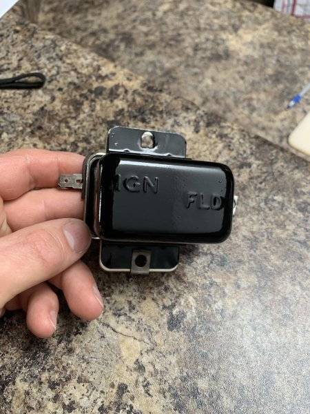

I have been using the vr Mr. Renton posted for a few years with zero issues. Found an original full-wrap housing in a yard, blasted it, repainted, and had a custom stamp made for a more original appearance.
I had one of the Electronic style bought from I cant Rember who when I did the resto 8 years ago. It took a dump in Albuquerque 350 miles from home. Got one from Autozone and it has been good to go for about a year. Looks like crap so I may have to get the FBO.
I did the same as Turbine…..found an original old cover, blasted, repainted, put it over the new insides. Then I had stamps made. Was less than $20 for the custom stamps.
