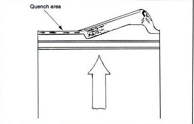

Adam, maybe this will help. This quench stuff is new to me, too. This is the basic concept using a domed piston. It's somewhat oversimplified, but I think you can get the idea.
