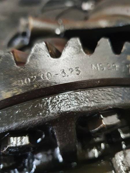

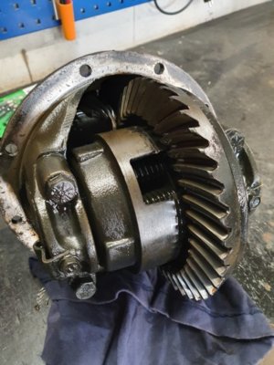

Wanna swap my 3.23 for a 3.91 ring gear on my 440 4spd 489 8 3/4 house.
Do i rebuild my flawless and silent operating 3.23 in the 89 or do i go for a already rebuild 89 house with a new Eaton Truetrac 3.91 that i have available.

Personally, I’d leave the quiet running 3.23 alone, and build up a separate complete unit for the new gears.
