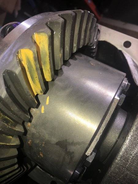

I changed out my 3.91's for 3.23's today. While I had it apart, I drilled and tapped a hole for a small drain plug. I looked inside and it does not protrude into the housing any more than the weld in the center of the housing. I mounted it off center to pass side of car a bit so I don't think it will even come close to hitting anything. Hopefully it does not leak. I just sealed it with RTV.
I realize the interval in draining the fluid is prob more than I'll ever reach but this might not be the last pumpkin change I do. I hate breaking the seal and hoping it all gets into my drain pan.

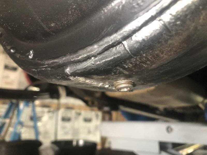

I had my driveline shop weld a half coupling to the bottom of mine so I didn't have to worry about it sticking up internally too far. It also gives more meat for the threads since the housing is too thin. Too bad their weld was crap and it leaked. I'm in the process of resealing it with some JB Weld to try and avoid rewelding it. Not the best picture, but it's the best I have right now.

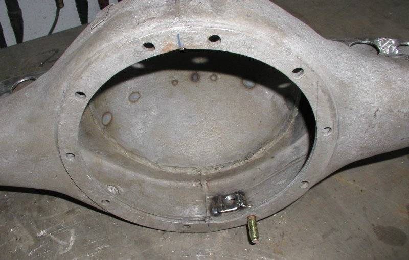

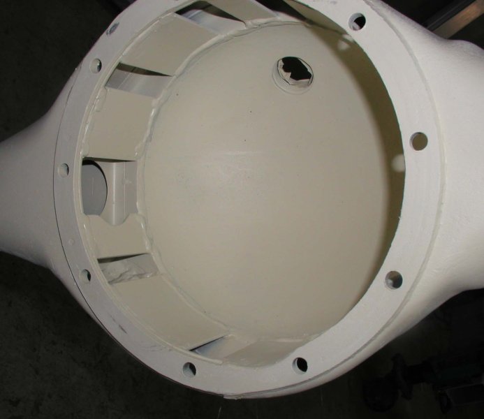

I found pics of my internal drain plug reinforcement from years back below. For those with a keen eye you may also notice my rear end cooler pick up point before it was enclosed with a welded baffle, and a finished pic with fill/view port and all the internal slosh baffles and housing stiffeners.
I mostly disagree, even with a 1/4" drain in 1/8" metal. A brake line retention bolt has few downsides if it dislodges. The same cannot be said for a drain plug.
Baffles are interesting. Where did you get that idea?
I agree that it's better to weld on a bung or something other than just relying on the the threaded thickness of the housing. It would not take much effort to strip the threads.
