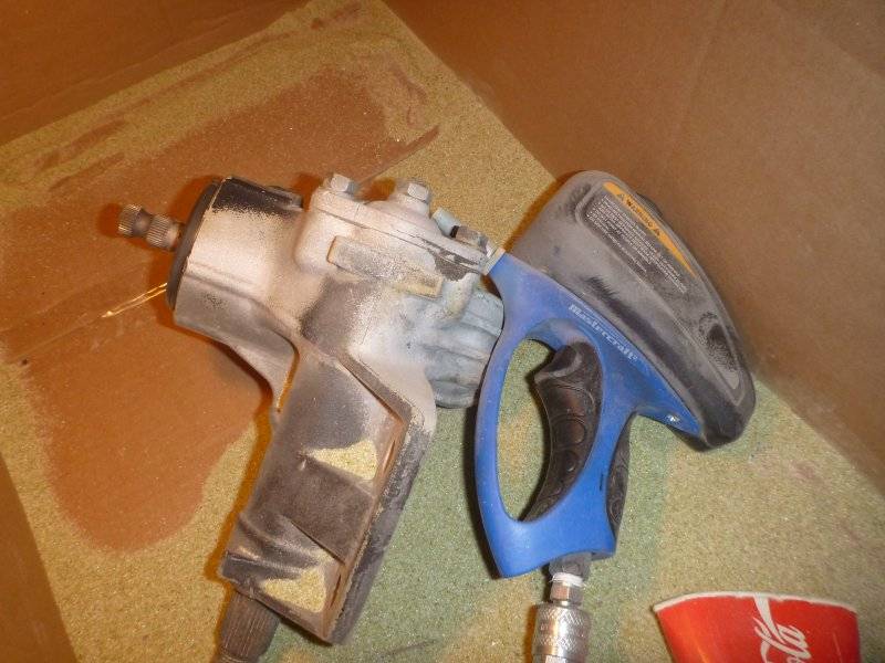

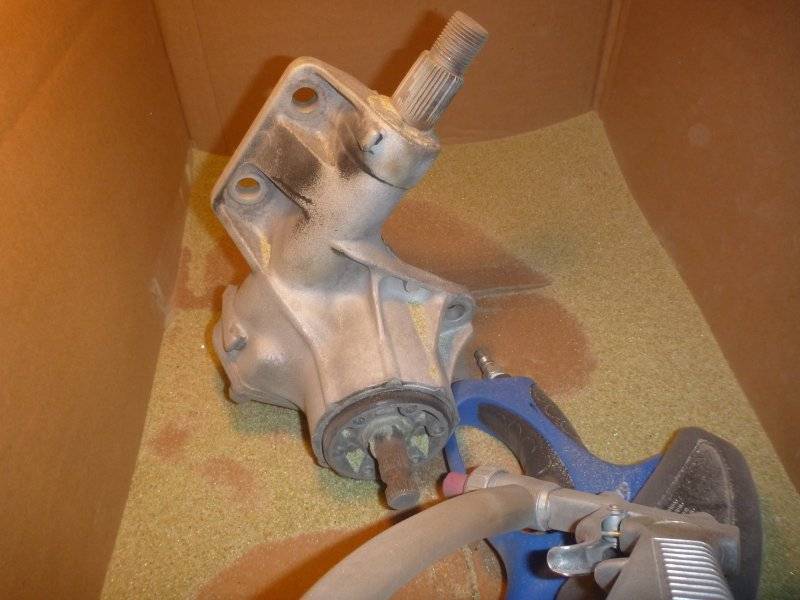

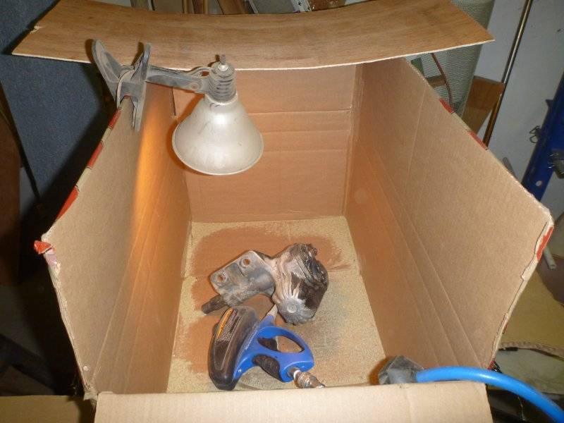

You don't need a big compressor to run a spot blaster. I bought that for less than 40 Canuck bucks during a 40% off sale at Canadian Tire. Harbour Fright or any junk took shop would have one.

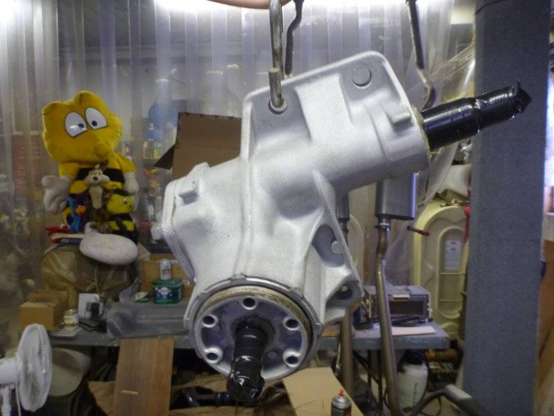

Worn out glass bead will leave the surface matt/dull, and fresher bead will have a better finish. For the best look, some NEW beads in the hopper, and blast a little to get them to the gun before finishing will leave a shiny silver/aluminum finish.
