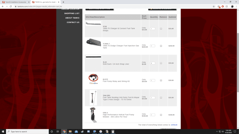

Starting to price out an in-tank setup for the 1200+hp dual fitech I'm running. Going through tanks inc, placed what I thought I'd need. I know I need to run a relay as well (not sure which one), but, what else am I missing?
Also, would I need to run an external regulator before it hits the FiTechs?
ST98
1968-70 Charger & Coronet Fuel Tank Straps Only
$35.00 $35.00
TCR9A-T
1968-70 Dodge Charger Fuel Injection Gas Tank Only
$250.00 $250.00
SL24
Sold Each / 24 inch Strap Liner Only
$5.00 $10.00
RLYFP
Fuel Pump Relay and Wiring Kit Only
$39.00 $39.00
TAN-ORG
Fuel Tank Sending Unit Early Ford & Mopar Type 5 Hole Design - 73-10 Ohms Only
$35.00 $35.00
GPA-9
High Performance Hellcat Fuel Pump Module - 450 Liters Per Hour
The fitech regulates voltage to the fuel pump so a relay would not be needed. I did run a relay on my race car so it works either way but I did have a regulator.
I would check with fitech to see if it will run that pump for sure.

It all depends how many amps the pump pulls. If the pump draws more than 10 amps you'll need to add a relay.
IMO:
Tanksinc tank and sending unit, yes.
Tanksinc fuel pump, no. NPT fittings suck.
At the time I did mine, the Hyperfuel in tank pump didn't fit the Tanksinc tank ring, so I drilled it bigger and used the pump mounting ring.
I believe now you can get a Hyperfuel pump that fits the Tanksinc ring.
Hyperfuel has AN fittings.
Or, find another pump with AN fittings that fits the ring.
If you get the Hyperfuel throw the in tank fuel line and clamp in the trash, get the proper submersible line and 2 clamps, not 1.
I got the 'corvette' filter/regulator, Wix brand with kit, and bolted it to the frame near the tank.
One line to tbs. Bought regulator block offs for the tbs, BMW iirc.
PTFE braided line with Fragola fittings, easy peasy.
No relay, but I did buy/install wiring for one because I found conflicting info, but not needed.
