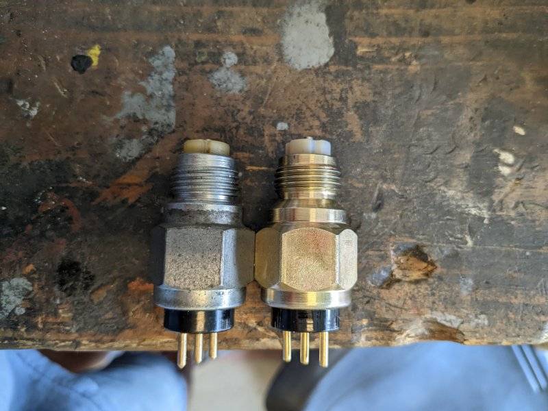

Tried one from AutoZone. Same issue. I saw on a form the ones from auto zone would work. Nope no reverse lights unless I unscrew a turn and a half. I double washered and snugged up a bit more than hand tight for now. Not really happy but it all works. The bevel is also different see picture.
The one on the right looks chinese. Are you using a washer that should have come with it?
