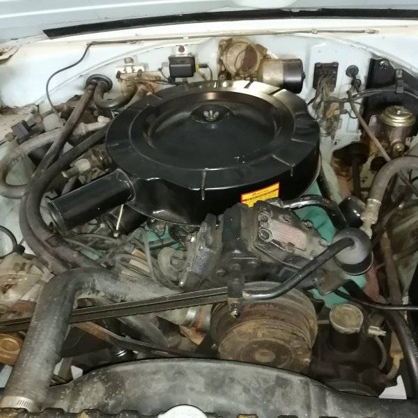

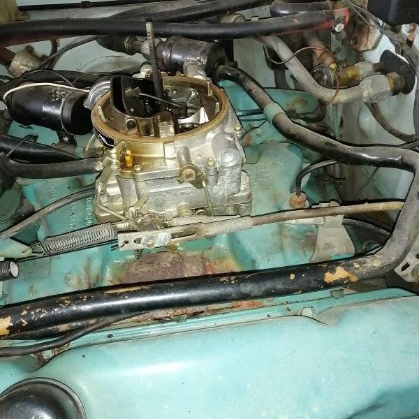

I thought this was a classic move. The previous owner installed an AFB four barrel on the 361. He used a late model spread bore manifold and an adapter, not great but workable. When I removed the carb I realized he had the adapter installed upside down. He also used a dropped air cleaner base under the stock air filter lid. It didn't clear the rubber fuel line, so he modified it, sharp edges and all. Thankfully he didn't go any deeper into the engine.
