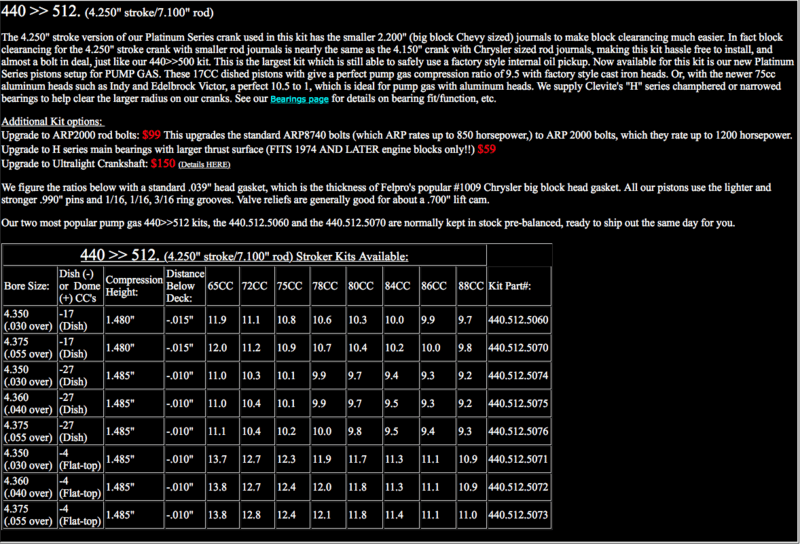

For your engine I would use a 4.25 stroke withe 2.2 rod journals, a 7.1 length rod... 17cc dish pistons will give a 10.2 C/R with 84cc chamber cylinder heads which is enough for good power but you'll be able to buy fuel anywhere...
Heads, your asking for a street engine & don't need the biggest HP so I'd stay with the Edelbrock 84cc heads...
Cam? A flat tappet these days with the number of failures is a poor choice... If you lose a cam you potentially lose the whole build... So that means roller cam & for this build I'd be looking at the Lunati 20230713K...
There are lots of small parts left but that gives you a great foundation for a fun street engine....
Oh, I'll add this from 440 Source...
