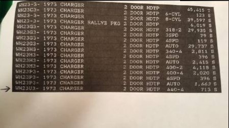

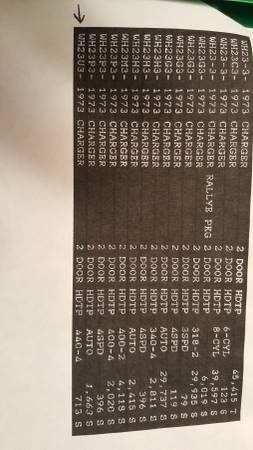

Wow..! ! You wouldn't happen to know how many 73 rallye's where made with the 440 ?
I have a print out from the old owner that's says 6,019 rallyes where produced, and
713 440's in that year , but not how many rallye+440's ..? ? ?

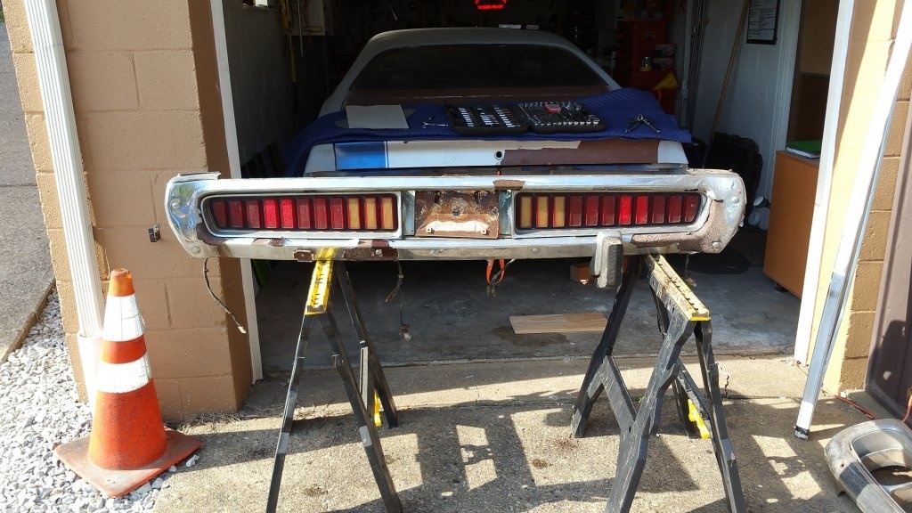

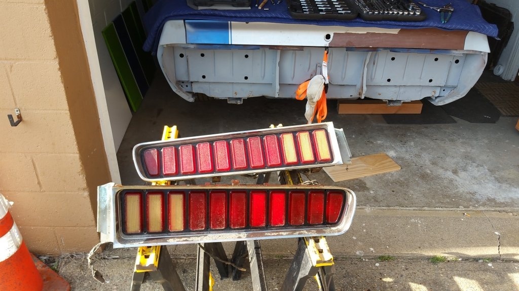

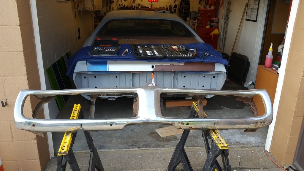

Would love to see some pictures of your project. Bezels are not reproduced and very hard to find. I suggest you keep looking while you reassemble and some will turn up. If you manage to get NOS, you will pay a lot for them and good second hand are hard to get. Maybe try Tonys Parts, he is a vendor on here.
Thank you on the heads up on the bezels,
I found a guy in Kentucky that had the whole bumper assembly. .he said the bezels where un broken but the bumper rus was squeezing the one .I told him to leave it alone , jumped in the truck 10 hrs later I had then freed from the bumper with out a brake , :) plus I got some good moldings , and extra license plate stuff.
The search also netted me an un dented nose ! ! Also he had the thin rocker panel rallye trim . 1 needs some love , but the other is in good shape .4 bills , Friday was a good day
Thanks again for the heads up..
