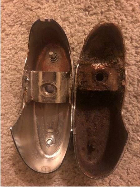

I bought a 1964 SF on eBay and the front and rear bumpers were bent and slightly rusted on the inside. I was debating between straightening and re-chroming or buying new. Classic had a 20% off deal so I bought new AMD front and rear bumpers about one year ago. They looked good and I was pleased with the quality.
I liked the look of rear bumper guards, but they were hard to get. I finally got the guards last week. Today I was going to put the guards on the bumper, and then put the bumper on the car.
The guards would not fit. It turns out the vertical alignment of the hole in the bumper is 3/4” off from the original bumper, and there is no way to make this work. So, my plan is to go without the bumper guards. I hope the new bumpers still fit the car without other interference.
Bottom line: New or existing rear bumper guards will not fit new AMD reproduction bumpers. If you want the bumper guards, get your old bumper refurbished.

I SCREWED UP. One person ask me what AMD said about this, so I ask them. I got a very responsible reply asking me to send details of what was wrong and they would check it out. I'm not used to good customer service. So I took pictures and took more measurements and the bumper holes DID seem to be in the correct place. So I compared the bumper guards and the difference was in the hole placement on the reproduced bumper guards as seen in the photo. I will contact AMD and apologize. Many companies sell these bumper guards. I'm not sure if they are all made by the same supplier, or not.

Ok so the guard you have is not an AMD part?
FINAL CHAPTER. No the guards are not made by AMD and I just got a note from PG Classic telling me what went wrong. They list bumper guards for 63, 65 Plymouth Bumpers. They do not say 63-65. PG explained that the 64 bumper is different and that the repo makers probably don't want to make these for just one year. I hope others can learn from my mistake and be sure to read the fine print. What a nightmare.
