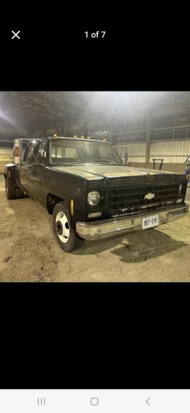

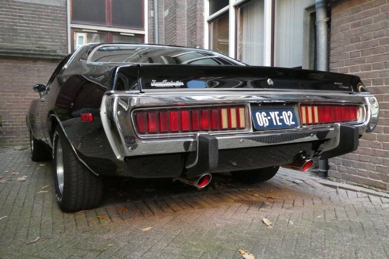

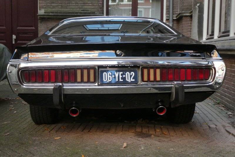

that's ok, I also got a reply that said if the chrome is in rough shape it will be exponentially harder for me to prep, sorry for the shitty pics, this is Scott, the ScottsdalePlease let me clarify my earlier statement. I agree with 33 IMP's (post #27) statement that black bumpers look good on some trucks. Black bumpers on cars are a recent development (think tuner car crowd or plastic bumper covers on modern cars like the one in my avatar) and screams laziness when on a classic muscle car IMHO. Fortunately, each person is entitled to do what they want with their own cars.
On a side note: I asked my powdercoater about doing a couple pieces in chrome but he said he doesn't recommend it because when he tries to clear coat it the part begins to haze/fog. He did suggest a powdercoat that looks like an anodized color (like black chrome). Next time I'm there, just for grins, I'll ask him for bumper recommendations.

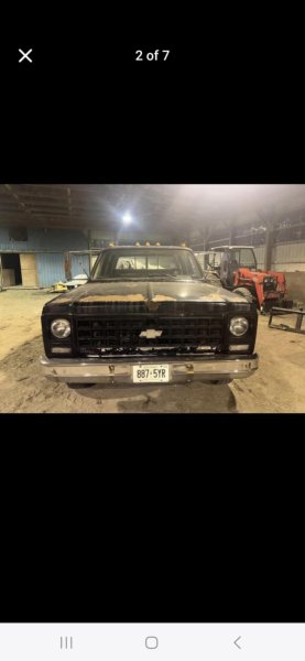

in the short run, whats on it, once we change the rubber, dtraw we're thinking alloys, but if we stay with steelies I like your colour choiceI can see using black bumpers on the truck in the picture. What are you going to do with the wheels? Black also? Powder coat them in black chrome, maybe the bumper too?
Go to Youtube man! There are dozens of videos about how to do it. Grinder voor hard steel? What horror movie have you been watching lately?so just for shitz and wiggles I messaged 3 chrome shops, one only does hard chrome the other 2 both quoted fair to good quality as $2700, (best I can expect with the shape its in) show quality is north of $6k, no promises,
so back to painting, its peeling bad around the bolt holes, and has quite a few cracks, best way to strip it? grinder disks for hard steel? then abrasives like rust remover disks and flap disks? what about electrolysis?

problem is its peeling off in strips back from the bolt holes with surface rust started underneathI'm no expert but I don't believe you have to strip off the chrome. It's already bonded to the steel. It just needs to be roughed up with sanding so that fresh paint will bond to it. That's what my body man did to my Charger bumpers before painting them body color.
Just grind it off till the peeling parts are gone, sand it and spray with expoxy primer (not edging). Use filler to straighten out any irregularities. Sand it again, repeat till satisfaction is reached.problem is its peeling off in strips back from the bolt holes with surface rust started underneath
