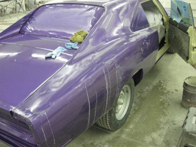

Spit, Light Sand & Polish & Then Home To Reassemble !!

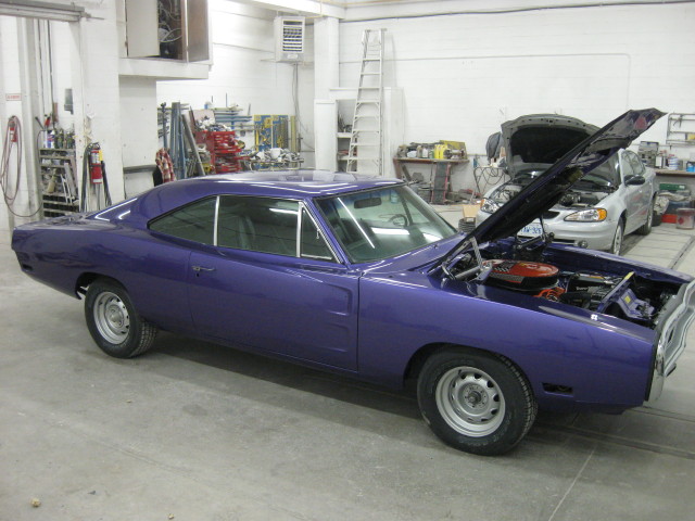

Going fast now, :grin: Time to Final Reassemble. :yes:
Working Out The Bugs!!!

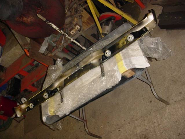

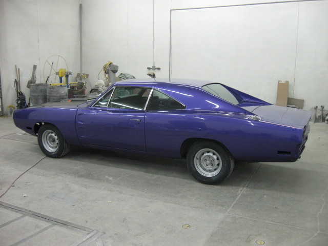

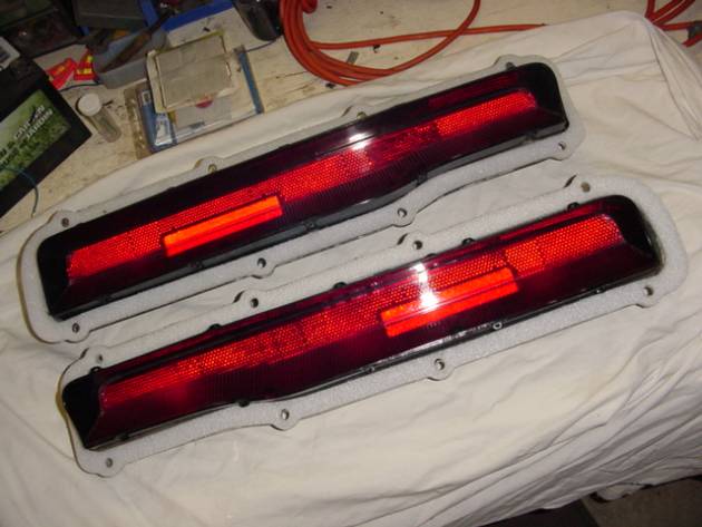

It`s getting so close now that i can feel the wind in my hair> I can`t believe i`m this close. Put the door handles on today. I`ve had these in the factory box for 19 years, bought them as a set in 91 when i went to Carlisle PA.

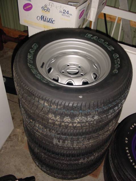

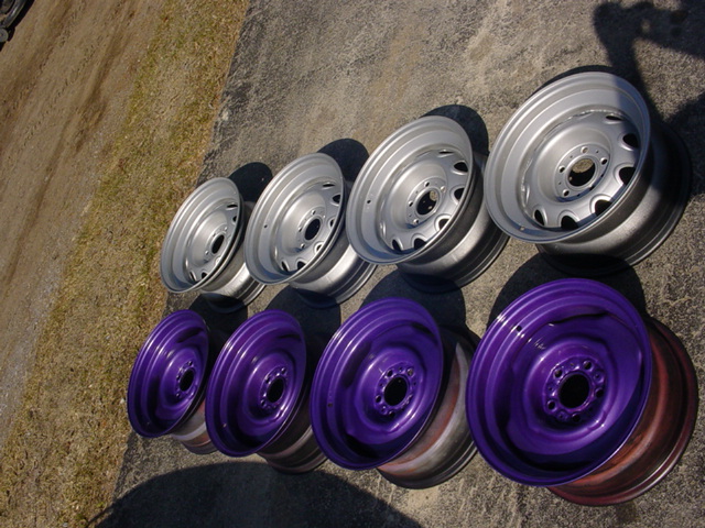

Eventually i`m going to have three different hoods ( this airgrabber, a factory C7 flat hood w/ 440 callouts in black & a 69 1/2 glass scoop flat black like the RR ) ,two different deck lids ( this one and a plain C7 ) and i already have 4 different sets of wheels, to change the apperance of the car to drive or to show it as it was factory. ( these 15x7 rallys w/ Goodyear Eagle GT+4`s, 15x7 C7 steelies w/ss dog dishes w/ original Goodyear Polyglas G6015`s, magnum 500 w/center spinners & original Goodyear Polyglas G7014`s and 14x5.5 rallys with redlines.)

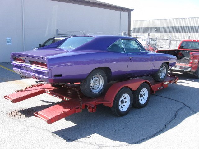

Well this is it! 28 Days to the Prom. I went Plum Crazy today!!! :grin:

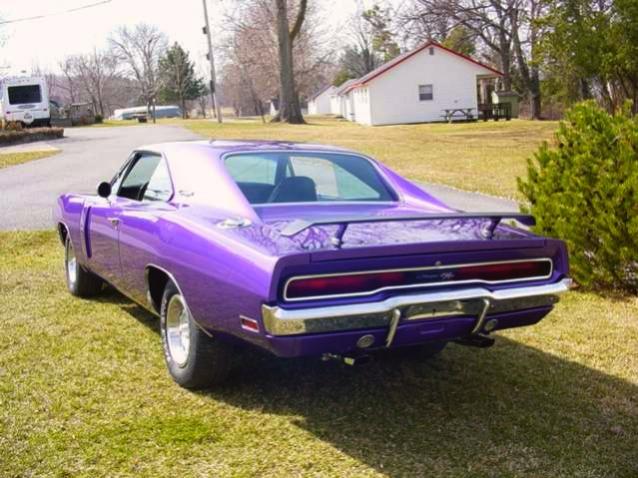

It was warm and sunny and i saw ALOT of rubber necks out when i took the car to town for the first time. Does she ever pull hard when the secondaries come in ( now i know why they made "depends" ) :rolling: . Other then alittle boil over after shut down, everything went GREAT!! Didn`t abuse it ,just used it. Got my cost per mile to around $1,000.00 as i put 72 miles on it today.
I can`t believe there isn`t more bugs , when i think back to were i was and every nut, bolt and screw got worked on. The original service manual, that i bought years ago, was an incredible help.

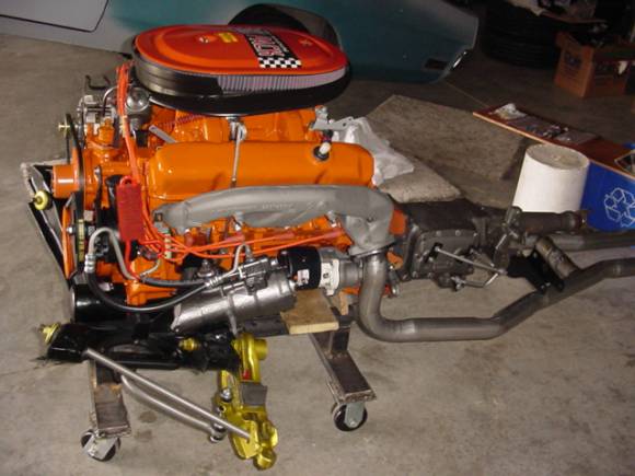

YEE HAW High Speed !!! A Few More For The Pic Lovers !!!
Just got high speed, WOW what a difference!!!
Had the car out three times now,1st for 4 miles ,again for 28 miles and last Sunday was 68. Got just over 100 miles on the car and Tim @ www.forhemisonly.com wants to give the engine a tweek!! So far it looks like it gets about 10 mpg. :grin:
Over heating was from a bad original cap. ( looked good ,but that`s it )

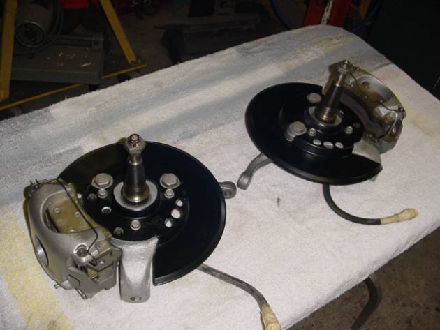

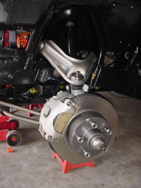

Leaking caliper was from not being machined flat on the flexline surface after being glass beaded. Sent it back and now it`s done right, :yes: no leaks.

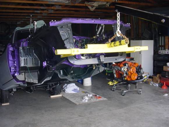

Here`s a few more of the " in the process".

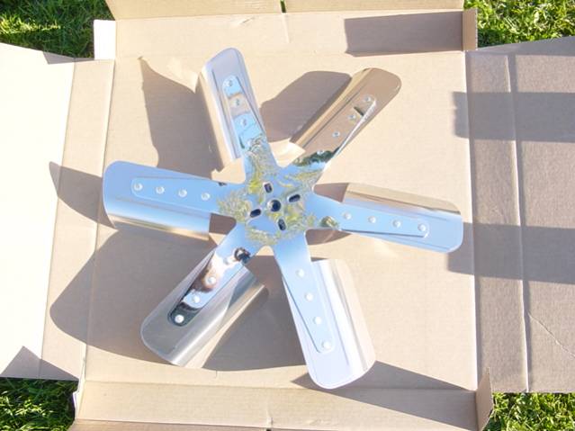

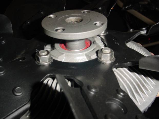

Still having a heat problem. Went to see Tim today @ www.forhemisonly.com ,just down the road and he recommended i loose the 216 fan & the clutch & go with this 6 blade flex fan with a real good cup.:edgy:
I can see i`m going to have to boost the clutch pressure up a notch or two ,as there`s just too many ponies trying to run loose for the factory clutch plate. :grin:
Run a good CUP?
I hope he isn't thinking a flex fan is gonna fix your problem
He tells me it`s not pulling enough air through the rad & shroud at lower RPM. The engine compartment is too hot?
